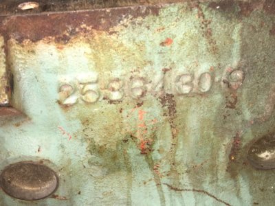

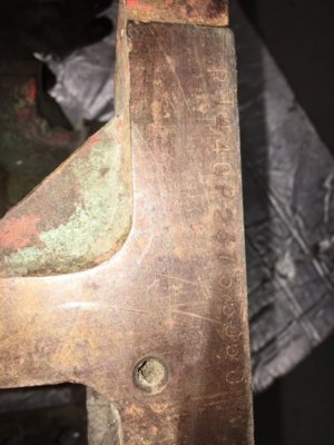

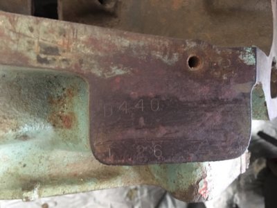

Looking for some info on a couple of 440 engines.
Over here they are quite rare to come across, been offered a 1968 440.
But i cannot identify it, owner claims it came from a 68 charger.
The engine number is PT440P23736050, the P after the 440 never seen before, have been told if it had a S means Hi performance, but a P perhaps Police??
Front pad is D440 =68, date code looks right and casting number looks right.
but top of picture by drilling looks like a C, could be LC (low compression)was told a wrong way round C could indicate 6 pack block but no HP stamp on pad?
The owner is a few hundred miles away so not easy to pop over to look at, and is not a car man.
Was it only the RT 440 stamped HP and the standard charger not stamped HP,
Any info would be great

Is a 68 block, would be stamped HP if it was high performance block. I believe the pt= Trenton plant

The block up for grabs Engine casting number is right, the pads right but no HP, the C on the pad is a mystery.
The block engine number PT440P23736050 points to coming from the right plant PT Trenton but the extra P after the 440, I didn’t think it should have a letter there
It’s hard to decode you read one thing on the net then something contradicts it and your back at square one.
Few books I have don’t really break it down enough.
