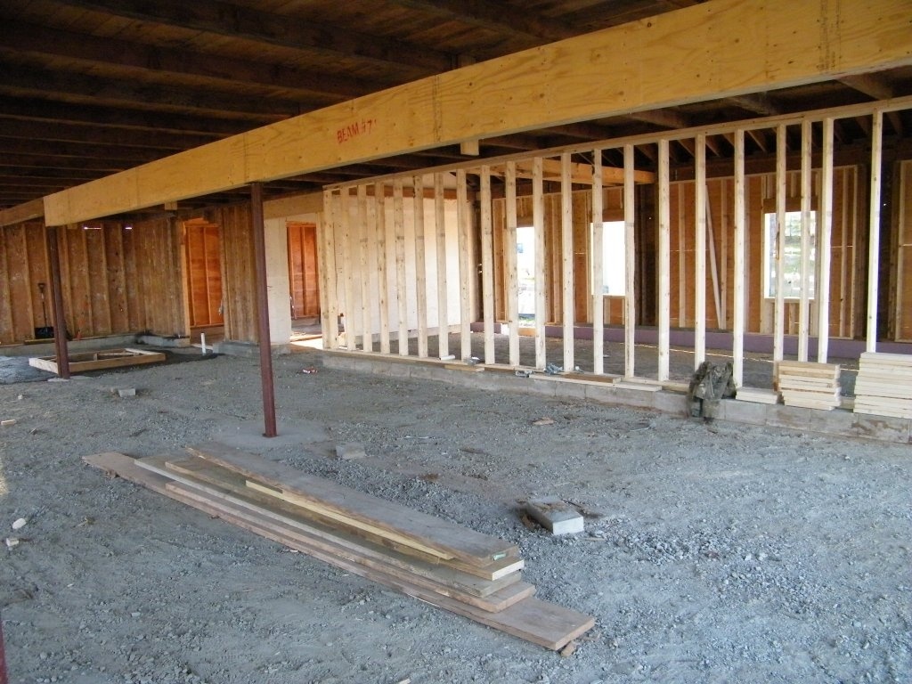

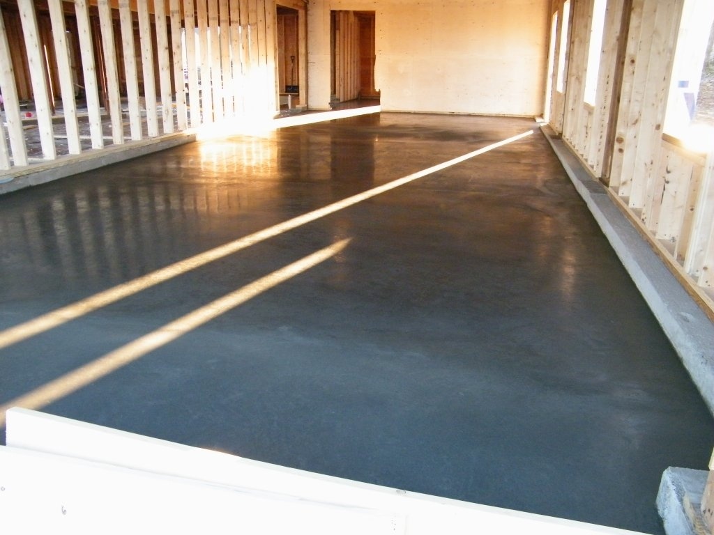

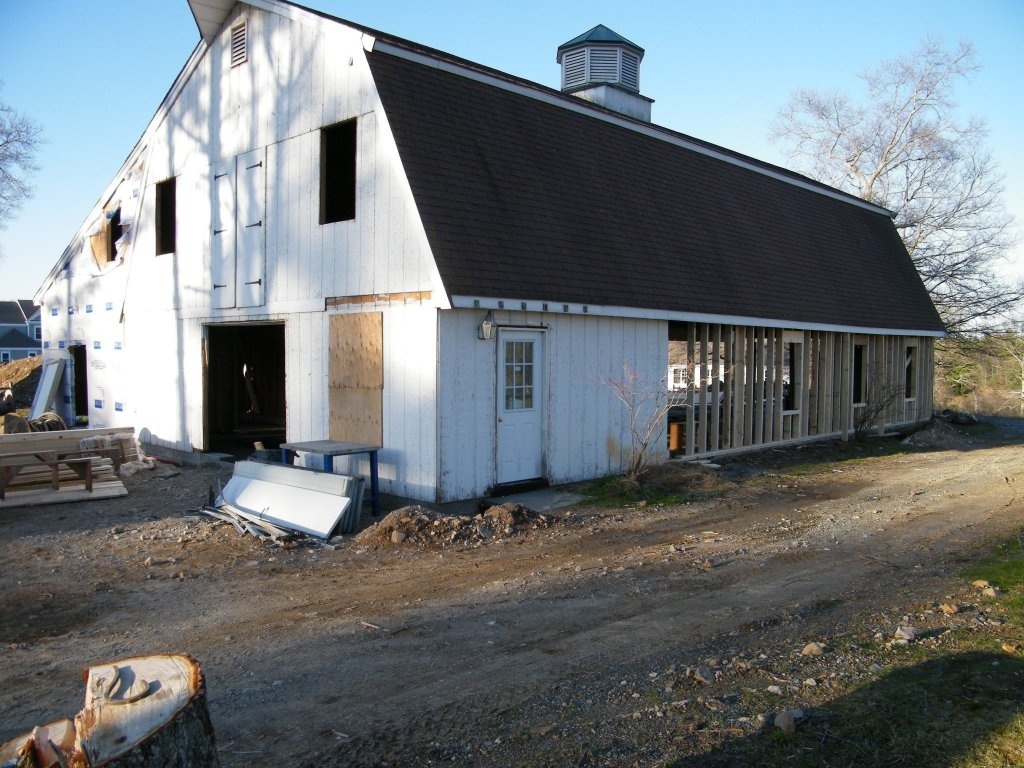

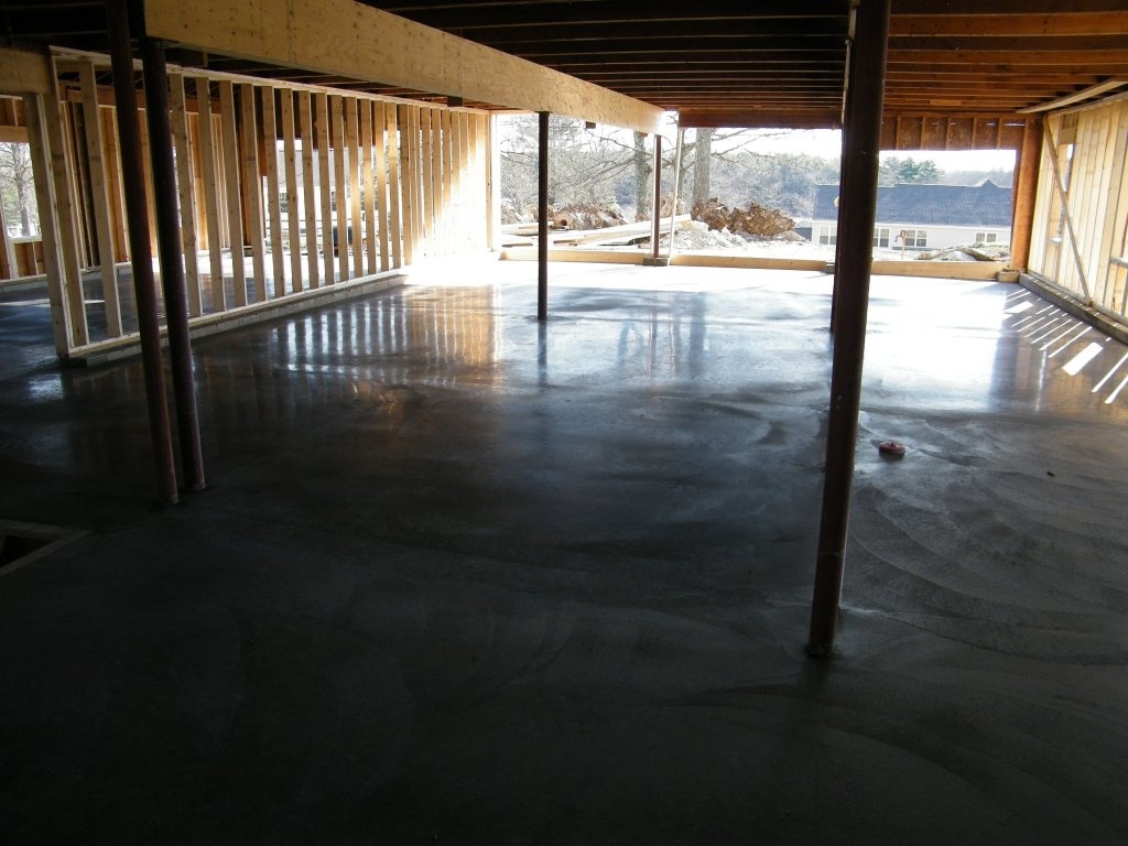

The demolition/prep work has been slow, but just this week, the framers (finally) showed up on Monday. Once the ground floor is done, the floor will be poured and then start in with framing upstairs and creating the dormers.
Looks great! None of us ever seem to have enough room, and my 3rd bay, although super nice, still suffers from lack of space. It looks like you will have a lot of space, and the 5" of concrete will allow for the addition of a 2 post lift if you choose to add one.
