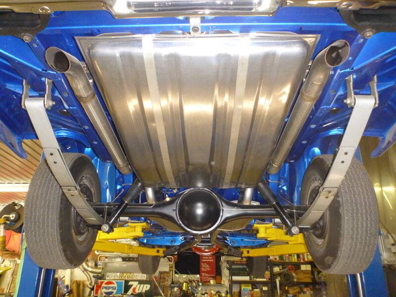

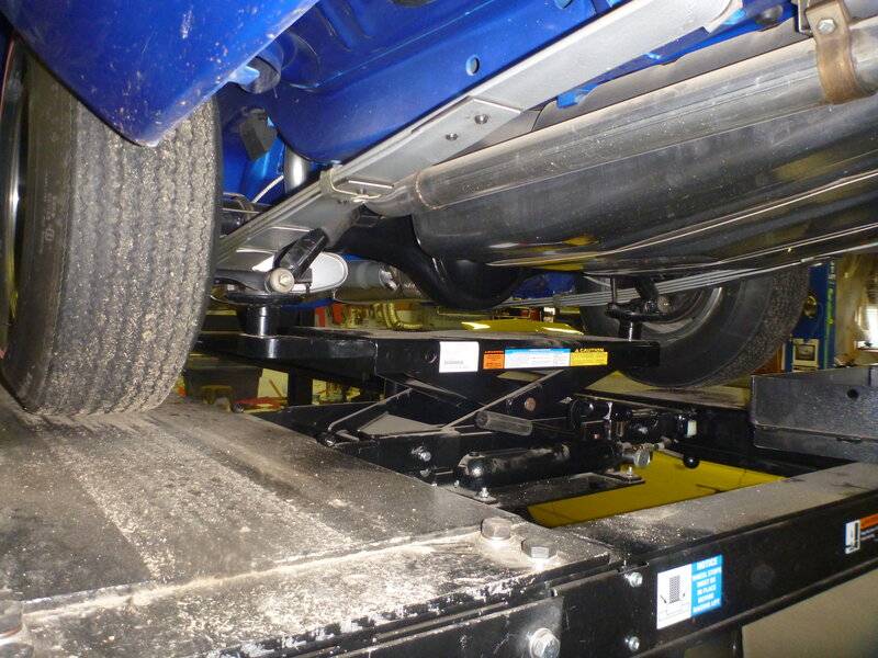

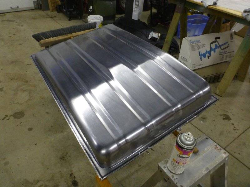

I'm for clear coating it... mine 5 years later now and I live on a gravel road.
