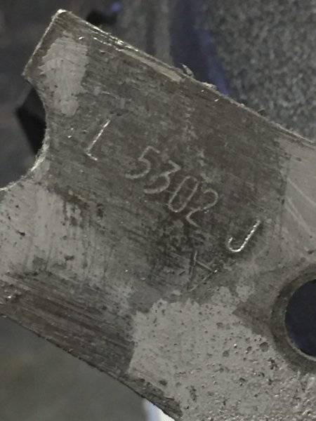

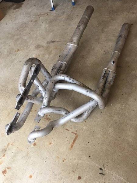

These are Hooker (discontinued #5302) under chassis 2 inch tubes).
No tubes go thru the inner fender like Hooker #5209
Have Flowmaster 4-2-1 collectors.
Paint flaking and a few dents.
$400 US plus the ride.
Were in my 67 Belvedere and Coronet previously
We’re in my 67 Belvedere and Coronet previously

My 1st thought is what dvw says & see if you can find someone in the UK to weld in a new piece(s) of pipe & repair what you have. That is by far the cheapest way to go. My 2nd thought is....Do your Hookers have "slip tubes" (primary header tubes that slip into the collector area)? Did you just bend up a "slip tube"? If yes, then I believe Hooker sells INDIVIDUAL tubes, so you could just buy the tube you need & slip it in. If you smashed the collector area, that won't work.
ok welded up the tubes, and tried to pull out the flattened spots, its ok for now will work for this weekends racing
