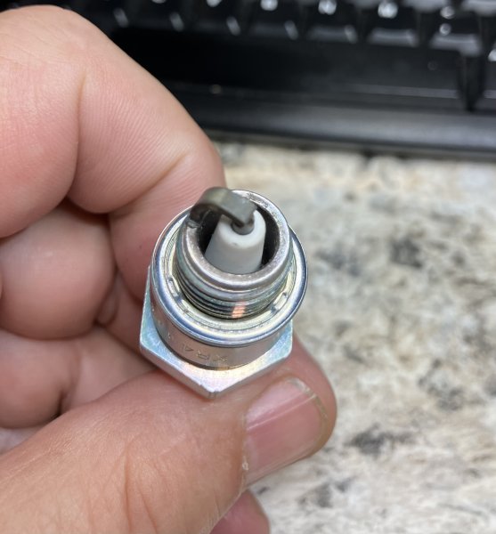

My suggestion is a trip to the chassis dyno to sort out the jetting & timing.

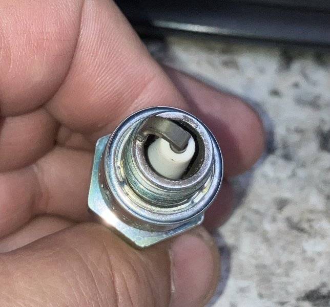

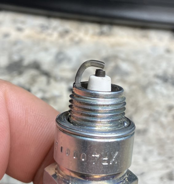

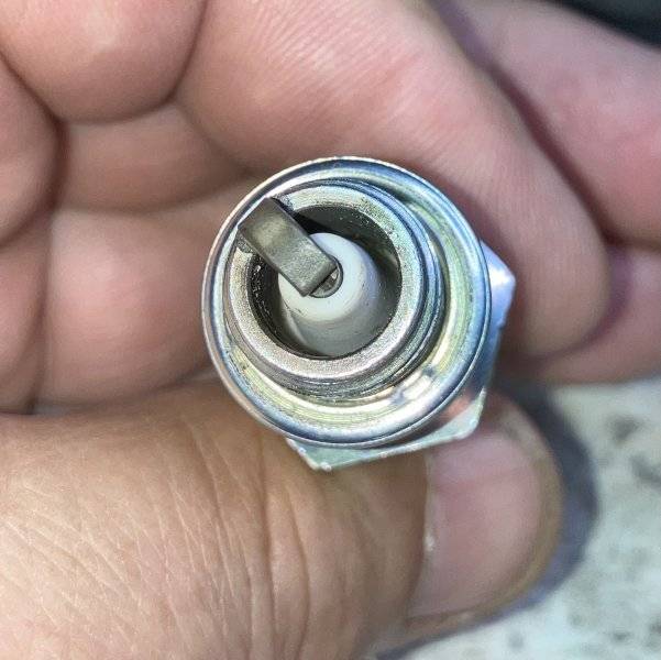

I agree the gap looks small. In general, you want more gap as compression (either static or due to superchargers/ turbos) increases.I know the gap looks small, I dropped it a couple times.
I run them at .035”, but installed plug in staging lane and removed it on return road. A little hot down there and dropped the plug, probably closed the gap.I agree the gap looks small. In general, you want more gap as compression (either static or due to superchargers/ turbos) increases.
I'll have to un- agree on that one.I agree the gap looks small. In general, you want more gap as compression (either static or due to superchargers/ turbos) increases.

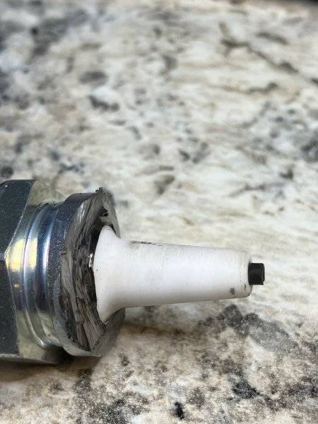

I’ll cut the threads off and have a lookThe color on the porcelain will only be about 2mm right at the base. You need to look deeper.
