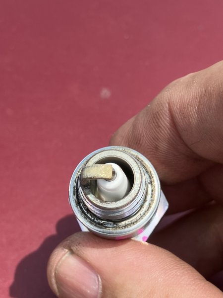

This is a plug from cyl 4 and 7.
One 1/8 mile pass, immediate shut down.
What can you guys tell me?

I agree with the plugs look a little lean.

Those plugs look lean to me,
I'd go up another 3 jet sizes in both front & rear,
at least the fronts
with a power valve it's usually in the range of 6 jets different
between front & rear

probably too hot of a plug heat range too, go down 1 colder in range
run it check the plugs again
maybe; also don't use the extended tip style spark plugs either
may not be needed, they tend to be hotter too, like 1/2 a range
but do 1 change at a time,
'test It' & read the plugs
probably too much total timing too, try 2*s less also
go from there,
read the plug between changes, look at where it burns on the strap
a lil' less timing will "usually" also help in MPH
more timing at the hit sort of helps, if it's needed
that's just a band-aid for miss matched parts thou
& do 1 change at a time
so you'll know what it was, what works, keep a log of what you do too
weather, cloud cover, sun or cold & condition of the track
& read the plugs 'between each change'
