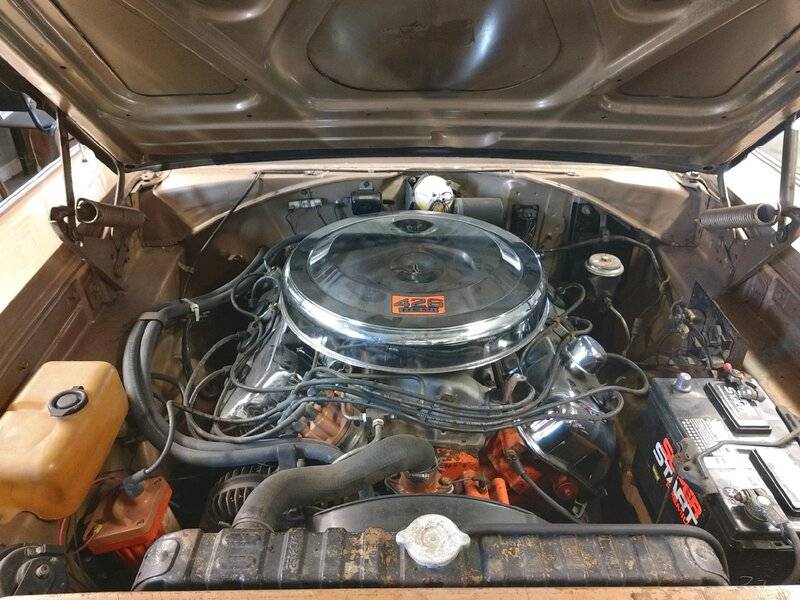

Welcome! I'm in N. Peoria. I have a 1st gen Hemi, '57 392 in a '55 Coronet.
Welcome to the shop!! Thanks for the engine shot.

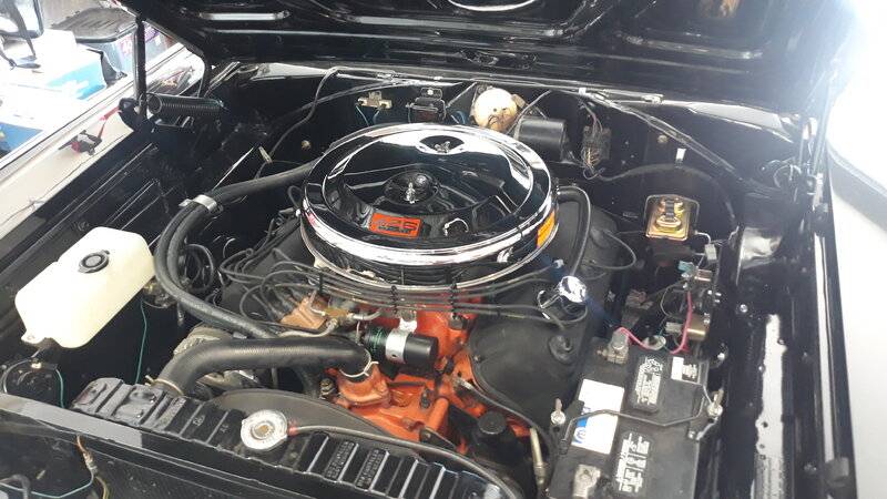

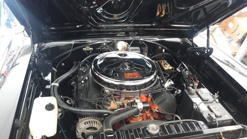

The very first thing I see that’s not correct is the distributor and the ignition coil.
Also the throttle return spring bracket for the front carb is the one for the rear carb can’t see the bracket for the rear carb with the air cleaner in place. And the factory ignition wire looms are missing. I’m not picking your ride apart but you asked for some guidance:lol:
No problem, I asked. I was aware of the distributor and coil, I think the dizzy is in the trunk, along with the alternator and starter, not sure about the coil. If it's not there I'll be looking for one. Nice catch on the return spring bracket(s), I wouldn't have known. I'll make a list of parts I have and what I need when the car gets here, plug wires, hoses and clamps, etc. etc.

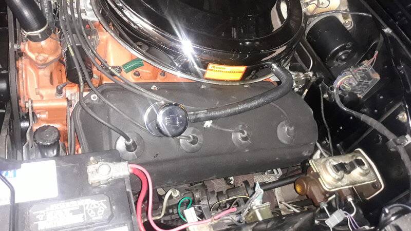

I'm curious about the relay on the fender to the rear of the battery, it looks funky to me.

FYI, the battery cables, radiator cap are incorrect. And mine was originally a manual steering car and has been converted, but they used a Saginaw pump. Hemis used the Federal pump

ps, the return spring bracket i see is the middle one.
should be a short one on the front end

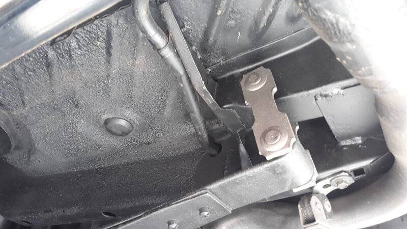

Thanks for the shot of the shackles, mine aren't like that. Does anyone know if you can tell originals from repro's- part numbers, stamping marks, other clues?
Spring shackles are not hard to find. Even nos.
No markings on them of any kind that im aware of
Thanks!
The relay is a '66 Hemi only piece - not easy to find. Welcome aboard - looking forward to seeing more pics! Seems like a lot of '66 Hemi Satellites popping up on here lately. Maybe we need our own forum. :D

Second, the car has leaf spring shackles with multiple holes for adjustment. They don't look original to me, and if not I need originals. Do they have visible part numbers, stamping marks etc?

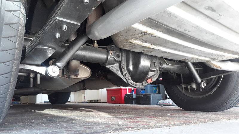

Third, what is the original finish on the Dana rear? Mine is dirty and looks to be painted Orange.
