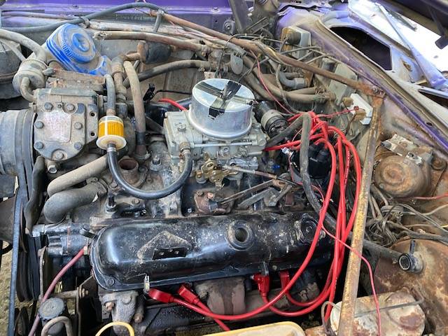

Can someone show my a pic of their throttle mechanism? I'm not sure how it all hooks up, along with the throttle cable. Seems like my throttle isn't going to work because the cable is way to long??
