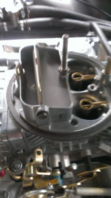

I'm the 2nd owner of this Holley, traded straight across for a tree stand on craigslist, it was flooding real bad. So I changed the o rings on the needles, changed my oil, pulled all of my plugs and cleaned them they were coal black and soaking wet.
So I started it today checked out float levels (good), 5" of vac. There was lots of white smoke on the drivers side tailpipe, it cleared up after 3 or 4 minutes. Put it into gear, and the idle didn't drop.....I thought that was weird. So I turned it down slowly and it died. I immediately stuck my face over the carb to see if there was fuel dripping and I didn't see any, but there was lots of vapors comming out of the primary side. I also noticed that the fuel pressure was holding in my clear filter, yesterday it bled off fairly quickly.
I'm wondering if my spark plugs are shot, or if there is still some tweaking left to do on the carb. Any help or guidance would be greatly appreciated! Thanks, Rich

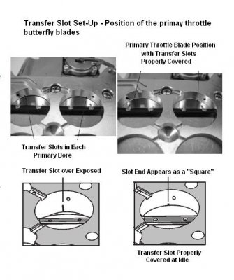

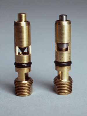

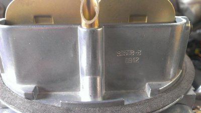

Alright guys, floats are properly set and they are center pivot, there is no trash in the bowls, the carb is a 4160 electric choke, shiny finish #80508-s yes the gaskets were smashed and I replaced them. I'm very familliar with volleys, but this one has me baffled. I'm running a mech. fuel pump, the 650 I had on previously had no problems with flooding so the psi shouldnt be too much for it to handle. I have 5" of vac at idle, I got the 3.5 pv because it was the smallest one oreillys had and on the 650 I was running it did just fine.

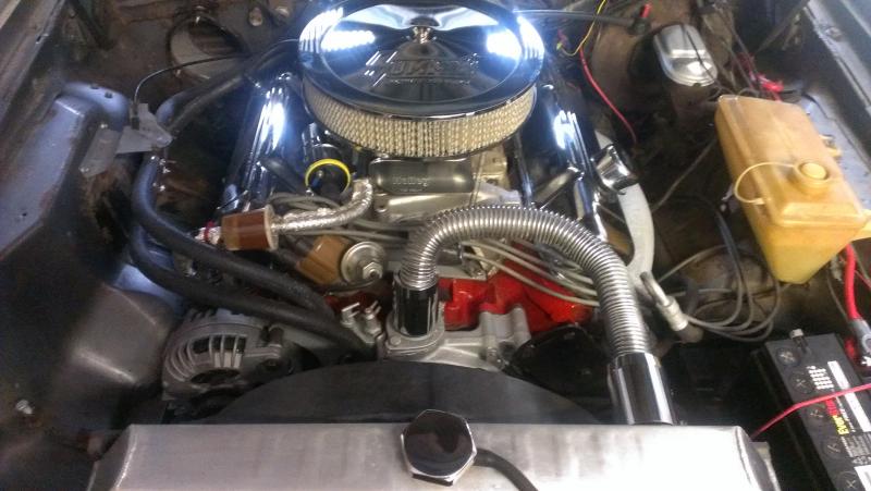

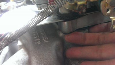

what is all of that under the base of the carb? How many gaskets do you have on it. Also is that a adapter plate under the carb?Is that gasket sealer on the gasket? If you are running a adapter plate they a bad at causing vac. leaks.and anything other than a good base gasket will do the same.If I were you I would rebuild or buy a new one.Change plugs and try again.If you keep running the car with the flooding problem you my find yourself rebuilding that engine.I am willing to bet you have a bad vac. leak.And fouled plugs.
I was waiting for that question, Its a mr gasket phenolic spacer, then there is the holley heat shield, w/ a 3/8 thick gasket. I dont use sealer on my carb gaskets. I put new plugs in yesterday, and only started it once and it ran for maybe 4 minutes while i checked float levels, so im hoping my plugs are still good.
Cant see it real good but the heat shield works wonders in the summer time. Best 30 bucks i spent on the engine.
Alright guys, I think I found the problem. When I switched pwr valves the gasket wasn't seated around the valve properly and was slightly canted causing the leak. Getting ready to put it back on the car and fire her up. I'll post the results of the start up.
