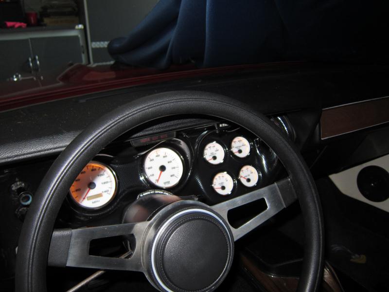

Finally got around to installing a new instrument cluster in my 73 Roadrunner. Bought the insert from classic last Xmas but didn't get around to installing it because i couldn't decide on what Gauges to use. Wanted to install the Autometer with the Mopar emblem but they were really expensive ( $1300) for 6 gauge package so went with the more reasonable made in Detroit (NVU) New Vintage USA for around $600.
Had some much needed help from my buds (Kyle,Rick and Don) so went fairly smooth and only took a couple of afternoon's.
Looks really sharp but have a couple of bugs to work out. Tach not working but becuase i am using a MSD 6AL ignition system so a Tach Adapter should solve that problem (I Hope). All in all, looks pretty sharpe and now i have viewable gauges for monitoring while driving.

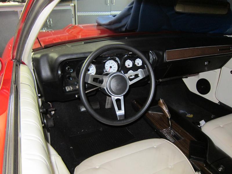

Looks good, gauges match the white interior.
Where did your radio end up?
Radio still with old original Rally cluster ,just in case i decide i go back to original down the road.
