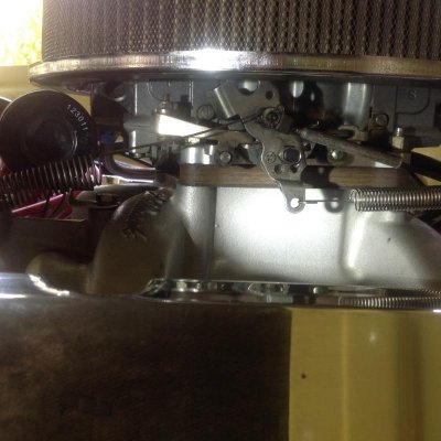

As you can see, no hood clearance issues however I don't what to go to high because I don't want to have to make the shaker hood to tall. image.jpgimage.jpg
One thing about our old mopar iron is they always had a problem with boiling the gas back out of the carb when we shut them off. High outside temps make it worse. That is why Chrysler came out with the Thermoquad with the plastic body to help aleviate the boiling process. The phenolic spacer should shunt some of the heat transfer and help some.
Phenolic spacer does help, I installed 1/4 inch spacers on my 6bbl (would have gone thicker but have clearance problem with air grabber) and wrapped the fuel lines from pump to carbs, seems to have fixed the heat soak issue.
Mine never putzed out while driving but had hard starting problems when hot.
Just ordered one of those 1/2 thick Heat Disapaters from Mr Gasket. I like the muti layer idea because with every layer you loose some transfer. Also have some heat insulation coming for the lines.

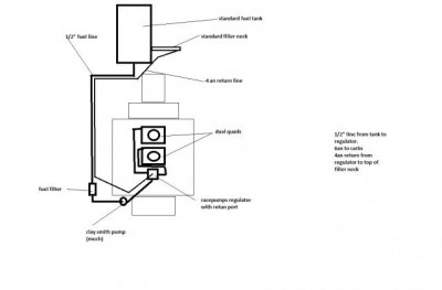

i ran a return line from my regulator back to tank, this got rid of all my fuel boiling issues, i just have other issues that i am over trying to fix.
here is a pic of my setup
I have a mechanical fuel pump putting out 7 psi and no return line since there isn't a regulator. I'm going to try and get a pressure gauge hooked up where I can see it from the seat next time.
