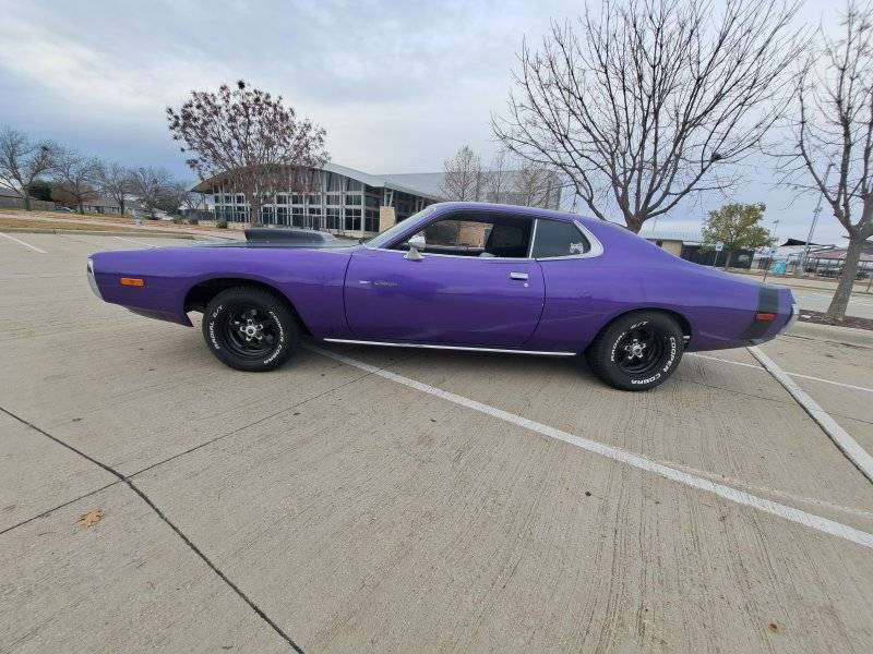

i have a 73 dodge charger.. i currently run an aftermarket wheel and want something different.. my current set up is 15x7 with 4" BS on front and 15x8 with 4.5" BS on rear... 235/60 on front 275/60 on rear.
i want to put the Keystone Klassic on my charger...
They are only offered in 15x7 with 3.75 " BS and 15x8 with 3.875 BS... they also offer a 15x10 with 4.125" BS..(don't think these will fit under my fenders unless it has 5.5" BS)
Has anyone got these on your 71-74 B Body's... I'm worried about spring clearance in rear and upper control arm clearance in the front..
The keystones you're looking at move the tire farther away from the springs and upper control arm, compared to your current setup.
I'd be more worried about rubbing the fenders.
I can almost guarantee the 15x10s won't fit unless you jack the back up to the moon.
Factory backspacing on rallye wheels is 4.25, IIRC
That lack of backspacing options cost them a sale to me. I’m sure they don’t care, but looks like this will cost them again.
I’ve seen other 69 b body cars with them and they look terrible with the wheels so far out on the front and I want them inside the well out back.
Yeah, I don't understand their goofy stock backspacing dimensions. Maybe they will fit a Chevy, idk. I run Keystones on my RR, and also had them on my 69 Charger. I had to have them made with custom backspacing, but unfortunately, that service hasn't been available for a few years now.
