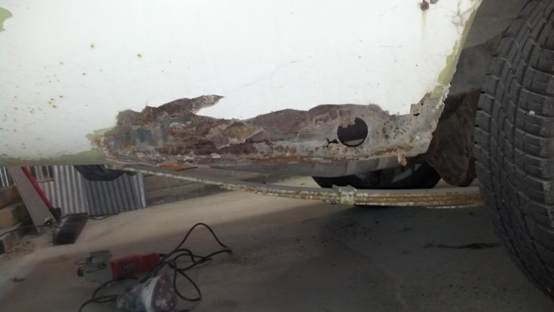

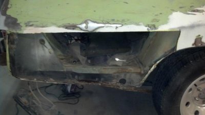

Just did on my 73
IMG_20131108_183430_570.jpgIMG_20131108_190211_546.jpgIMG_20131108_195441_794.jpgIMG_20131110_115042_903.jpgIMG_20131116_150119_663.jpg

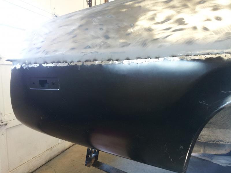

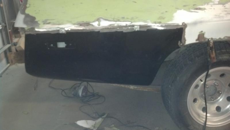

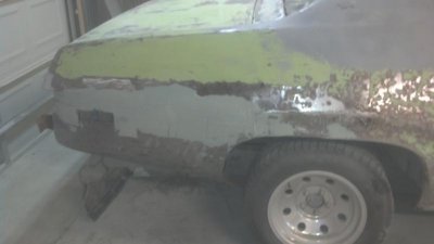

took a full weekend for one side, the driver side was already repaired but i did do some work to make it look nice
put the new panel up to the car and traced it, then took a grinder with a cut off wheel and cut inside of the line. Hung the new panel using these http://www.eastwood.com/intergrip-panel-clamps-set-of-4.html
tack welded, then just made tack after tack (no bead welds) on the whole panel. grinded down using a cut off wheel since its more precise then used a flapper wheel to smooth everything out.
Used body filler anything that wasnt even and sanded down

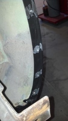

We are in the process of doing my 74 right now. Have the right side installed. Only thing we did that was not described in above posts was we used a crimping tool on cut edge to put a step in metal so new panel would sit more flush . Punched holes in new panel and welded through holes to new panel. Used a weld through primer between panels . replacement quarter RR.jpg
Should start on other side this week hopefully. Good luck.
