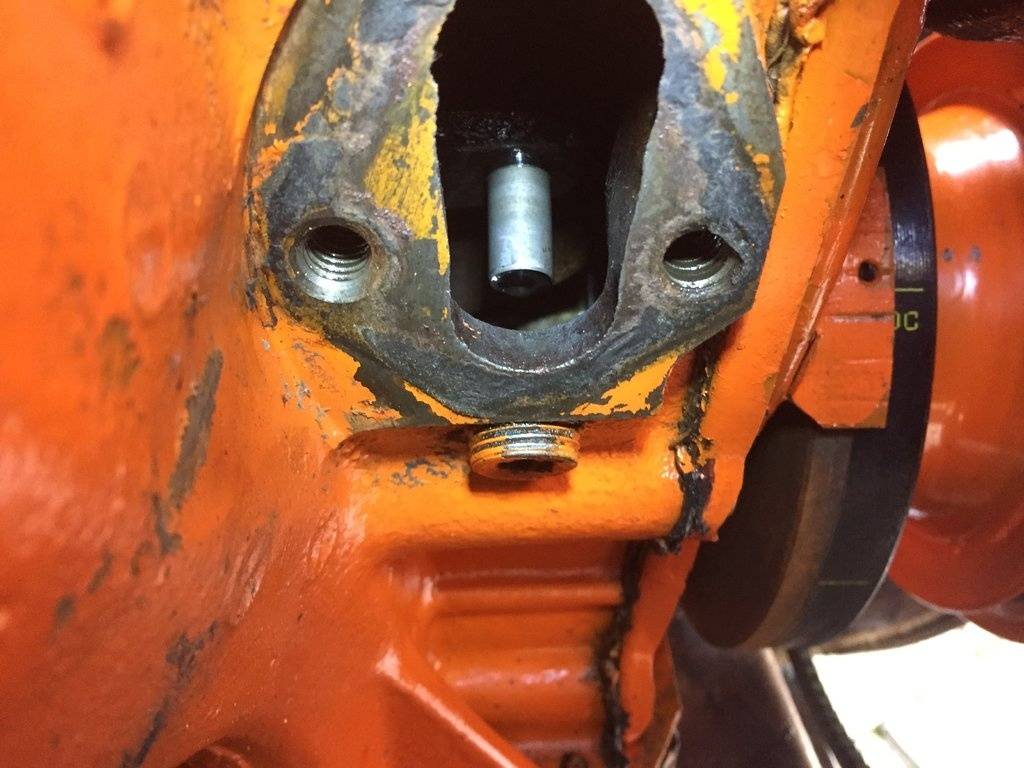

New mechanical fuel pump not working
Well, just tried the old pump and it's the same shite.
I checked the push rod in the engine as i could not remove the plug as the hex is damaged.
I noticed the push rod will not fall that far down that it actually touches the plug, it's not coming out all the way, so even with the plug out it would not just drop out.
The stroke it has is free and smooth, i can rotate it also with ease.
Strange that this happened by just pulling the pump, i am kinda lost now what this could be.

...remove the plug and it will fall out or stick you finger in there and back it out....
The plug being stripped is a problem. I am not sure if you can get a drill in there to drill it and get an extractor to remove it.
Ur pump rod won't come out without removing that plug and there's nothing else in there except the rod.
I tried to kinda pull it but it would not move anymore towards the plug.
The minimum gap between the push rod and plug would be 1/2" max, probably a bit less than that but i will not drop that far that it will hit the plug.
Look at the picture, it will not drop any further then this.
If the push rod won't drop down to the plug, with the pump out, one of two things. Either carbon/crud built up on the end inside the motor, or the end is flared. If the second...cam has to come out, to get the rod out.
Suppose you are putting the pump lever 'under' the rod. Need to get the plug out, one way, or the other.
I had a stripped hex on my block. Took it to a machine shop. I had other work for them but I let them remove plug. When I got it back with plug removed ask how they did it? They took a torx bit slightly larger than the size of the hex and drove it into the hex. Out it came.
This plug is rock solid, that will not come out.

There is nothing in there that can fall into the oil pan, other than the 2 bolts that holds the pump on. And those are, of course, on the outside of the motor. I would check to make sure the pushrod is moving when you turn the engine over by hand. Also remove the push rod and check the length.
Can you get to the plug with a MIG? If so I'd find a half nut close to the outside diameter of the plug (inside dia of nut close to outside dia of plug) and fill the nut with weld..... works everytime as long as your weld is good. The heat along with a much larger hex works wonderfully but with the oil and gas I'd wash it good, use fiberglass insulation to isolate the spatter, have a buddy ready with a hose and have a fire extinguisher ready.
Sure you can just skip to electric but I'd want to know why... That's just me though. As for electric pumps it's really a matter of what you want to spend but you could buy a Summit or Holley that doesn't require a regulator for just over $100 (cheap option). If you want to take advantage of the swap and eliminate vapor locking issues you would want one that requires a regulator used with a regulator that returns to tank. The last option keeps the fuel in constant flow eliminating the possibilities of it heating up near exhaust pipes and headers.
From the photo you have enough threads showing to use a punch to turn it...

If you remove the distributor, you can see the lobe on the cam for the fuel pump rod. Can also see the upper part of the pushrod, so you can get an idea what happened. Just mark the distributor at the block, and mark the rotor at the distributor. That way, you can put it right back where it was. Don't rotate the engine with the distributor out.

1/4" vapor line should be fine. You've probably got a varnish buildup on the pump rod. I've had to rotate&you'll at the same time to get them out. If I remember correctly, I didn't even remove my pump rod when I went to elec.pump for racing; it would just fall down enuf from gravity& wouldn't even touch the cam lobe.
I'm seeing enough of that pipe plug (and that's what it is, a common pipe plug) sticking out of that block to get a small pipe wrench (Ridgid pipe wrench - accept no Chinese substitute) on the outside of.
(I'm a career fire sprinkler guy - pipe wrenches is what I do in part - well, used to when I was younger, anyways :) ).
Been there, done that on mine just this last early spring. Same deal, hex was corroded in the middle of the pipe plug.
It'll fight a little at first, but should back right out if you have a good bite on it.
Hard to do in the car, sure, but if you can get any little bit of swing in the pipe wrench, it should give.
Heck, even a good bite with vice grips will work if you're strong in the wrist. :-)

I have faith you can get that pipe plug out of there and retrieve the pushrod (it will also come out with some effort, working it up and down to knock off the oil/carbon buildup off it). You can also use the long needle nose type vice grips through the pump mounting hole in the block to grab the rod and work it out through the pipe plug hole.
