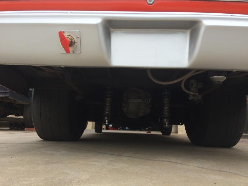

Billet MSD Distributor (No Vac) and MSD 6APlus. Thanks Mopar 3B and Michael789! The Denso alternator says it is internally regulated however I believe I am going to need to hook up 70 and later voltage regulator and run the green and blue wires. I really like the idea of the remote starter. I don't have the headlights in yet so I will be using a terminal block to power dual fans on the be-cool radiator and the headlights. Battery is trunk mounted and kill switch is in the bumper IMG_1831.jpg

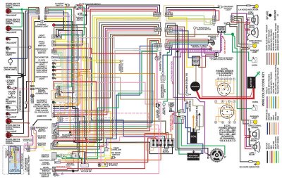

I have a color version of the 68 B-Body wiring schematic/diagram
should be close for under-hood stuff anyway

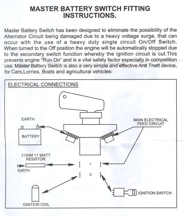

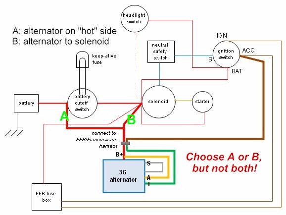

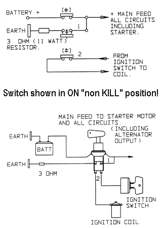

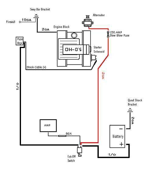

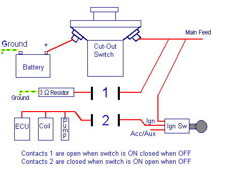

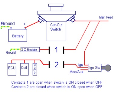

here's a few safety cut of switch diagrams also, depends on what it is you actually need
  • Mopar 68 B-Body Wire Diagram 1968 Charger Belvedere GTX Satellite RoadRunner Schmetic color.jpg
