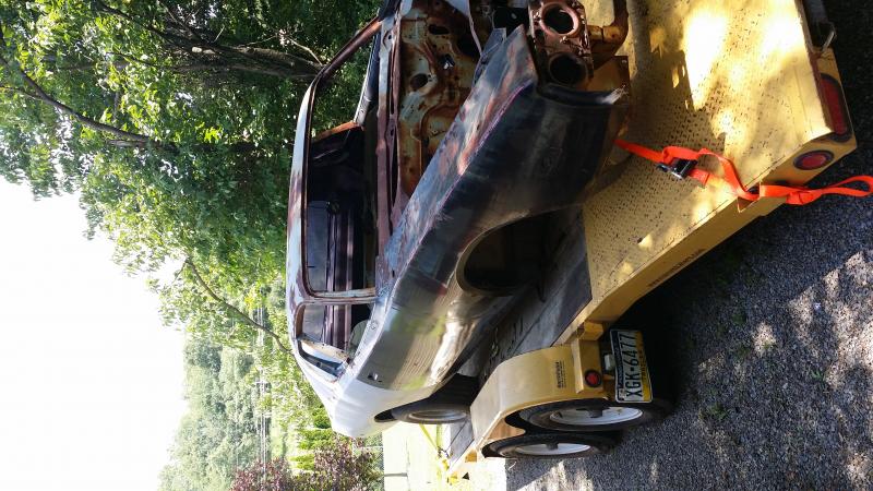

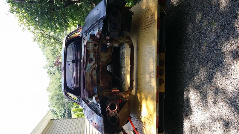

Question for ya guys the K member is damaged and can't be saved what year k members will work and difference between big and small block. The car has a running 318 and I have a 68' 383 to put in one day maybe undecided yet... also drivers side frame rail damaged what years will fit to replace that.... not looking for factory resto here looking for drivable ok car....

good luck and you and your pops have fun , we need to see the photos of the frame and k- member damage to help you out as to the repairs or replacement ideas :thinker:
Great looking ride. Do you have a picture of the K frame? It doesn't look like the wheels are pulled in and it may not be as bad as you think.

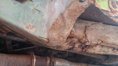

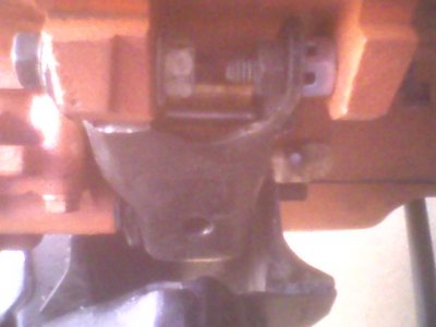

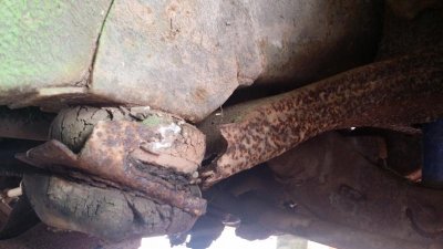

wow man, that is ugly. you might have a whole nuther' can of worms trying to get the K frame bolts out. you will have to try to get some lube inside the frame on top of the bolts, or they are just going to snap the welded nuts and just spin, then you will have to cut them off. you might want to just cut them off anyway , drop the k member , and then work the bolts out. the top pic looks like the frame rail is about gone. it can all be fixed , don't be discouraged

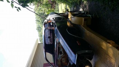

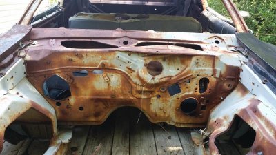

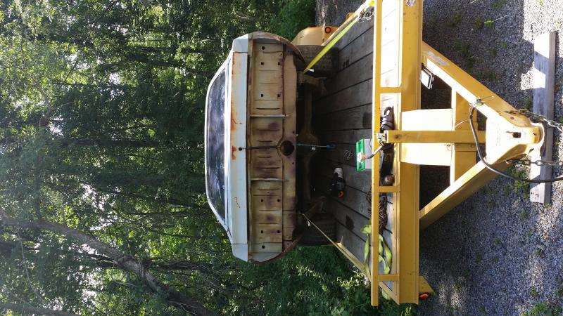

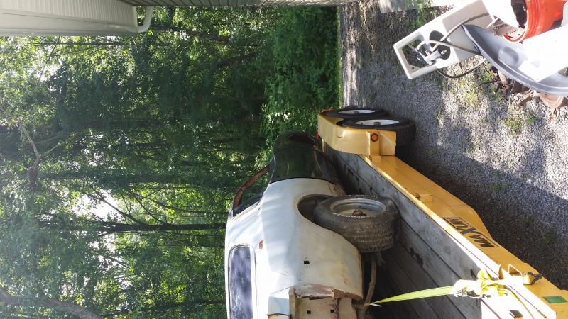

Well found a donor car so that's the new she'll and the green one is now the parts car... the new one is a 73 Brougham 400 car. The primor car is a solid base way better then the green car will be posting extra parts in the for sale in the near future.. have a front drivers frame rail available now
