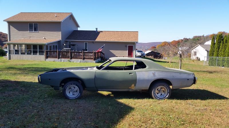

New project with my Dad....
Project with Dad 1973 dodge charge

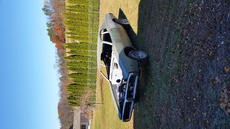

Little more work done....
20151103_123520.jpg20151103_123507.jpg20151103_123601.jpg20151103_123550.jpg20151103_123533.jpg

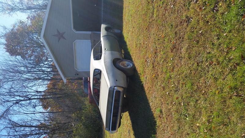

All the body panels are temp hanging for now.. but progress is progress
Been a while since I was on here been busy. The floor is going in tomorrow starting to move forward again.

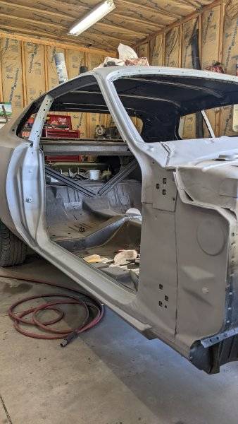

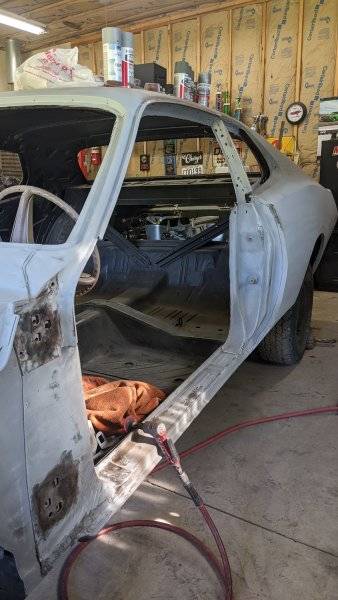

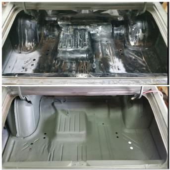

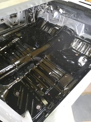

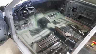

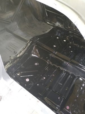

Got the main pan in. It took some customized work lol and help from my Dad's friend who can weld.

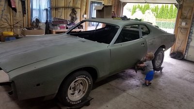

My little guy helping today. My dad's buddy welded in the rear floor pan. Floor is all done just need to clean up welds and repaint.
Got the floor done. Now onto finishing the engine compartment for paint. This years end goal is to have the engine together..

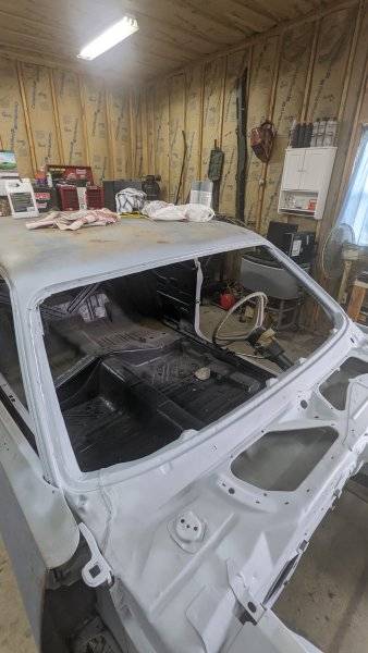

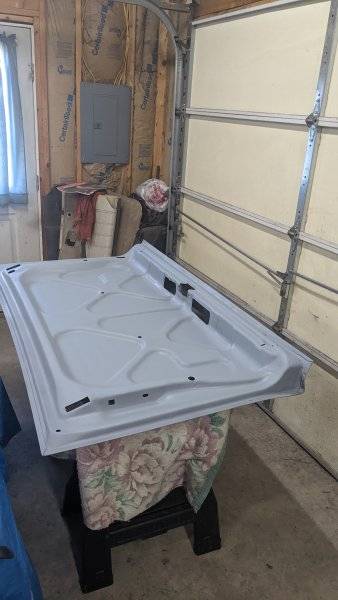

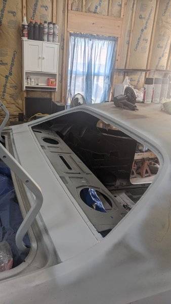

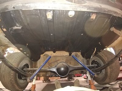

Gas tank mounting area all cleaned up rail to rail. Its the things people will never see that make the difference. And also make this take forever haha..

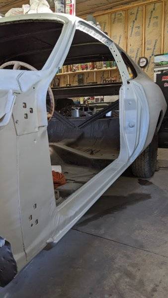

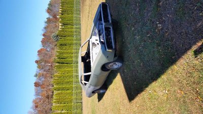

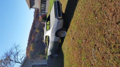

Well I'm back!! The car had taken a back seat for a while and spent a year at a friend's house getting the quarter panels patched and some other metal work.
The car sat kinda outside and we'll mother nature did her thing as well as time and rust had started again. Time to redo all of it haha.
