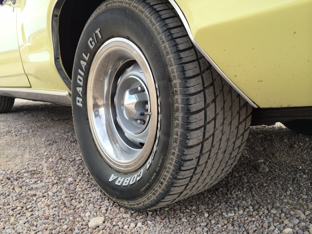

Bought new tires last week. I went from 1985 BFG belted TA to 2016 cooper cobra radials
I must say, with the shocks installed....my car now rides and drives as good as a modern day car. The shocks were nice, but going to a modern radial tire was amazing. It goes straight, doesnt wander. If i hit a bump the car doesnt leave the lane.
WOW, new tires really do make a nice difference
