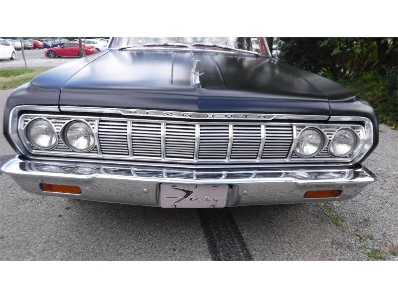

Hello All. New here. Although I have been lurking around for the past couple months. Figured it was about time I joined and introduced myself.
I have had my 64' Fury for about 4 months. It's a 4 door, Inline 6-225 engine. The car came down from Ohio to New Orleans on an open carrier through that terrible snowstorm in the northeast this past year. (Damn that carrier broker!) It was COVERED in snow and salt. After it was backed off the trailer I took it to a car wash and pressure washed the hell out of it. A few weeks later I put it up on some jacks and took a wire brush and some ACF 50 and tried cleaning as much of it as possible. The car, based on the photos was rust free when it was in Ohio, hard to TRULY tell tough. So far so good. Only surface rust underneath no pitting. Any tips on that subject would be appreciated.

I do have an electrical question. When I engage the right turn signal, both front signals blink. Left turn signal works as intended front and back. Rear signals are good both ways. Any ideas? I bought the service manual with the electrical wiring diagrams. When I have time I will dig in.
Thanks and looking forward to joining the community.
Welcome to FBBO from Ontario. That is a nice '64 Fury sedan you have. 4-doors don't get enough respect. I am working on my 1964 Polara 4-door hardtop. It was built in Canada, so it has the same dash as yours.
Welcome from the central coast of Cali. Signal issues most likely a ground issue causing back feeding. Clean the ones you can find. Also on the cast light housings, the inner steel shell for the bulb will stop grounding through the housing over time. Quick fix would be to somehow add a ground to the steel shell and hook it to a cleaned, no paint/rust spot on the body. Typical old car issues. Plan on updates there in the future.
