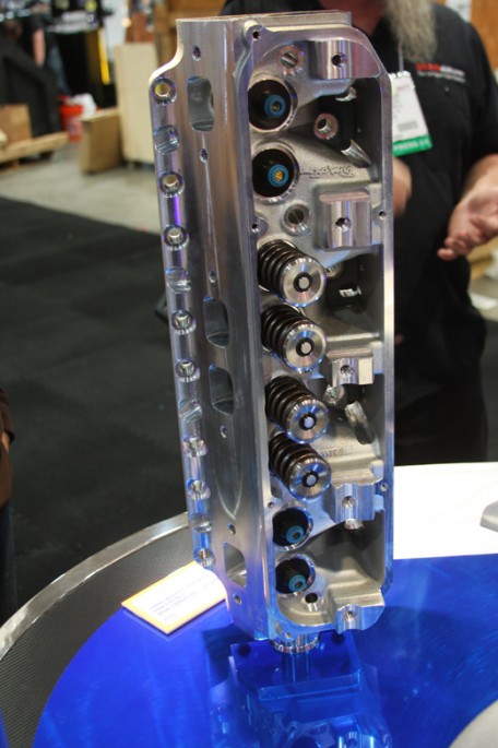

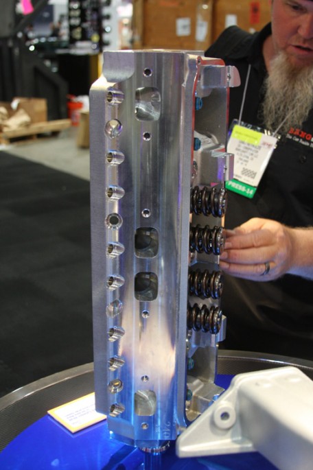

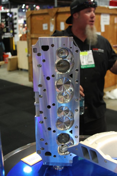

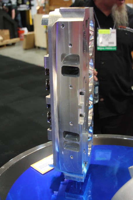

  • Cylinder Head Mopar BB Wedge 240cc CNC 326-253cfm @ 0.600 lift trick-flow-big-block-Chrysler-hea.jpg
  • Cylinder Head Mopar BB Wedge 240cc CNC 326-253cfm @ 0.600 lift from trick-flow Intake ports.jpg
  • Cylinder Head Mopar BB Wedge 240cc CNC 326-253cfm @ 0.600 lift from trick-flow Combustion Chambe.jpg
  • Cylinder Head Mopar BB Wedge 240cc CNC 326-253cfm @ 0.600 lift from trick-flow exhaust ports.jpg
