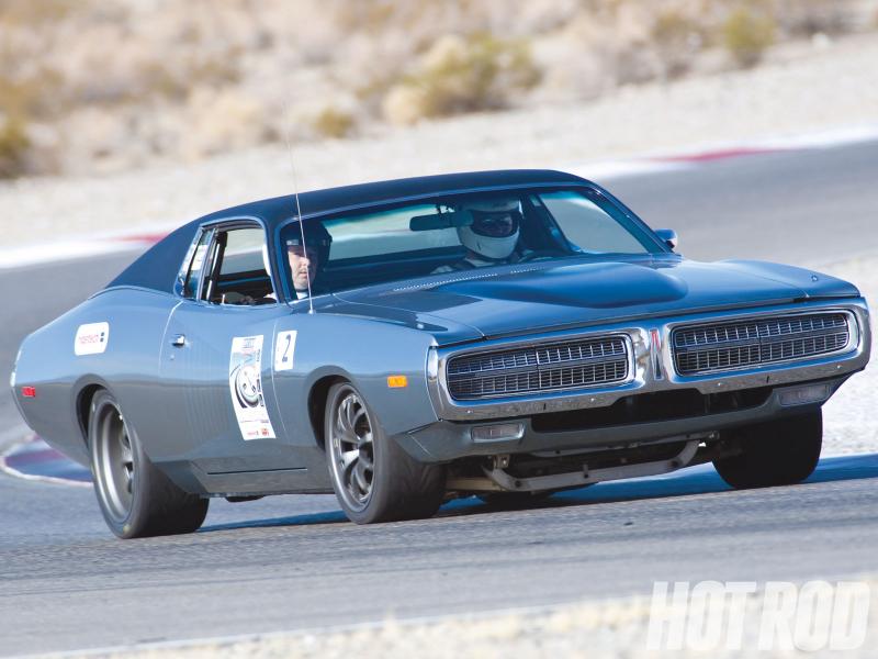

here is Bill howells charger, he is running 18" wheels with 355 rubber in the rear and 295 fronts, but it has some body mods. looks good I reckon and can handle round a track pretty well
