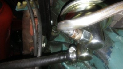

first of all i want to tell everyone on b bodies only , to have a safe friday,and give your loved ones a hug,,lol.ok after 2 days of looking for my gas leak from fuel filter,fuel pump,hoses it drips about 10 .nickel size spots every ride of 50 miles.,i finaly found the leak, well i hope i did,its coming from the aluminum threaded bolt from fuel pump.i just cant tell which bolt is leaking, so i ordered both male and female bolts and threads,it will be here tommorrow from parts store,so do i need to buy the whole fuel pump ?or just the 2 bolts from the aluminum fuel line from fuel filter,,just checking,thanks for all the responses ,cheers ,have a good friday. p.s.,i have a 1969 plymouth sattie,383.
It should be steel. Not aluminum. It's a flared line. If it needs replaced you could cut it off and the flare the end. Or go buy a 5/16 steel line and bend it accordingly. Or put a short one on and hose the rest. But it's not a bolt. It's a flared nut/line. But first just try to tighten it up.

i got it,its called a fuel to carb line, thanks.
It could be cracked looking at the pic.(real good by the way) Looks like fuel line got twisted. Let us know. Sometimes we forget our own strength.
