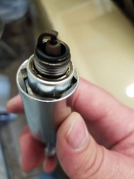

So the only major change I made was to go from .067 pvcr to .078 pvcr. And now my plugs are darker. But afr's are a little more stable at cruise. 12.7-13.2 depending on throttle position. When I'm cruising I stab the throttle it jumps to 17.0 for about 3 seconds before it picks up. I did go from a white secondary pump cam to a orange cam in the 1st hole, and dropped the squirt
er size from 42 in primary to 33. And 37 in secondary. First picture is with the. 067 pvcr, and 2nd picture is with the. 078 pvcr. I did read where going that big of a pvcr is a 39% increase in fuel. And I have a 6.5 power valve.
When are you reding the plug? If it's after a full throttle hit with a clean cut, it's to rich. 39% is a huge increase. If its checked after cruise it's to rich but pvcr has nothing to do with that. If it falls on it's face the pump cams/squirter size is wrong.
Doug
Doug

440 with a 284 484 cam . 10.5-1 compression 906 heads with a M1 single plane intake 950 modified quick fuel carburetor. 67 coronet 3700 lbs. 4.57 gears. 4500 stall. Runs really strong. The only major problem with the carburetor is the stumble while cruising.
