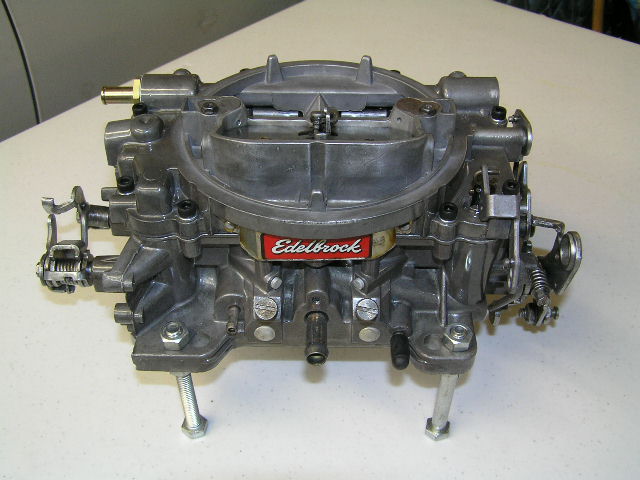

Ok finally got to spend some more time trying to get RR running right. At first could not get the car to run unless it was advanced 25 deg! Found a loose connection to number one cylinder so once that was fixed the idle smoothed out around 10 deg but would get a backfire through the carb when opening up the throttle. I think there maybe a couple of problems, the mechanical advance would advance too soon and for some reason running lean even after carb was adjusted. I pulled the distributor and found a spring missing from the mech advance, now I know this used to be a trick by the drag racers to remove one of the springs but this isn't going to be a drag car. Does anyone have an opinion on the vacuum advance whether I should leave it or not? In the past I have always taken them off. I know it will be difficult to start but it seems like it is always difficult to start. I am going to pull the carb and clean and make sure nothing is gummed up. The carb is a 1407 Eldebrock 750cfm, any other suggestions? BTW what is the circumference of the harmonic balancer?

Have any of you guys used the ProForm distributor? Have heard some negative feedback but will know more when I finish rebuilding the carb and get the car running right. I couldn't believe it, but the primary jets were in the secondary ports and both needles were worn out! Owner not that honest about pulling out of the box and putting on the car! Think I will keep the vacuum advance.
