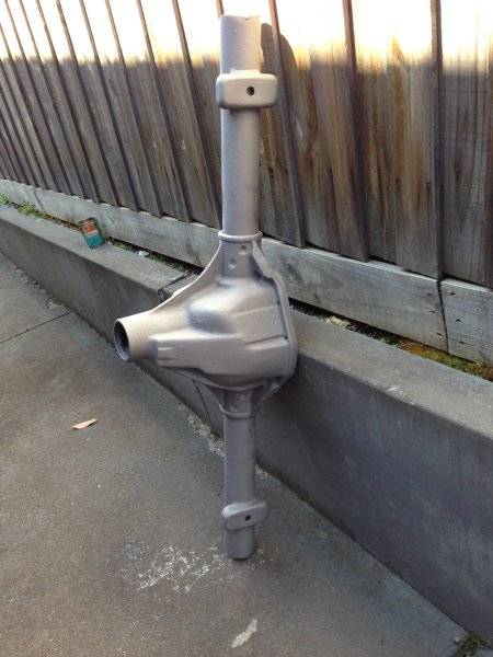

Some consider a ford 9” to be the next step up from a Dana.

Ford 9's are strong by size but not by design. There's a reason

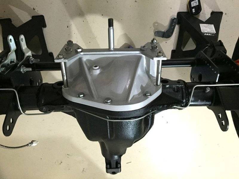

My truck Dana with, ladder bar, shock, wheelie bar brackets, 35 spline axles, spool, 5/8" studs, and the heavy cast LTR cover (6.5lb), w/o brakes weighed 172lbs. The solid rotor Willwoods can't weigh 20 lbs. The sure grip makes a Dana heavy. Spool saves a bunch

This pretty much sums it up. The 9” needs aftermarket housings and pinion support to handle the same power a stock Dana will take. If you build an aftermarket 9” housing with heavy wall axle tubes and back brace it, the weight difference isn’t as drastic. I’m pushing 1200+ whp through a stock Dana housing, rebuilt sure grip and factory gear set. The axles are 23 spline Mosers. It’s been sub 5.50 at 3950lbs. You can build a really nice Dana for $1500. I’ll have $4000 in my built 9” before it’s done just because the center section is so expensive.
