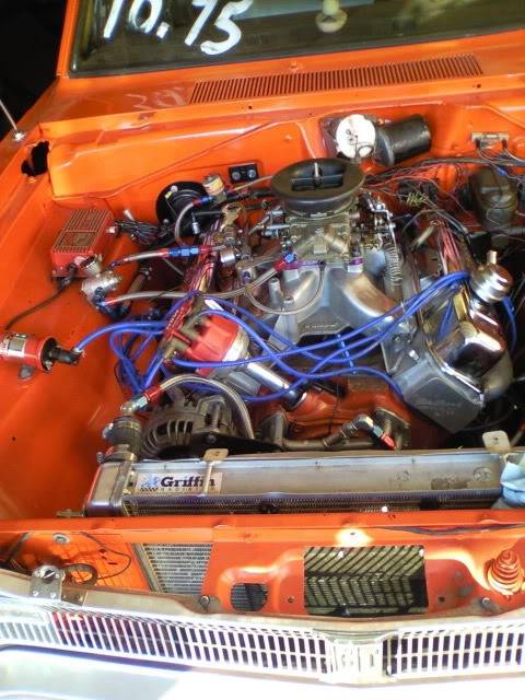

I have been thinking about going to nitrous. I looked at several setups but no completely sure of the outcome with this speed drug. I run a 440 with comp cam, jl forged pistons stock crank, elbrock heads and manifold. The car runs 10.9 Just looking for some thoughts on this.

I appreicate all that information. the motor is a drag motor with cam, 12 to 1 forged pistons, elbrock performance heads and manifold, the holley 1050 dominator triple valve springs, msd ignition, headers, no belts, roller rockers, comp cam, in southern cal with open exhuast it was running high tens. I had to go with an exhuast system here at Sonoma raceway and the best I have run is 11.1 I want that 10 second run 10.9 would be perfect. thats why I was thinkink a small shot just might do it without over doing it. Maybe theres another way I don't know this is a pretty well built motor from the receipts. I think it has its orginal steel crank. any suggestions besides gas? I run 112 octane but higher is available. Are there any os installers in N.Cal that know what there doing???

Interesting you mention the above items and yes its done. fiberglass doors, hood, fenders, lights removed interior completey removed, aluminum dash, 4 link suspension lexan windows, one race seat, window net, roll bar. I just bought and installed a turbo shifter with the air setup. shifting at 6000 rpm 1st and 2nd 2 step launch control at 4000 rpm with trans break. This may be the deal I am hoping for since the older shifter was a bit awalkward. Going to test it this Wed. night at the track. Rear fenders are tubbed. 5 gal tank in trunk, and two batteries, elect water pump two Mallory series 140 fuel pumps. You can see an interior picture. Just put it up.
