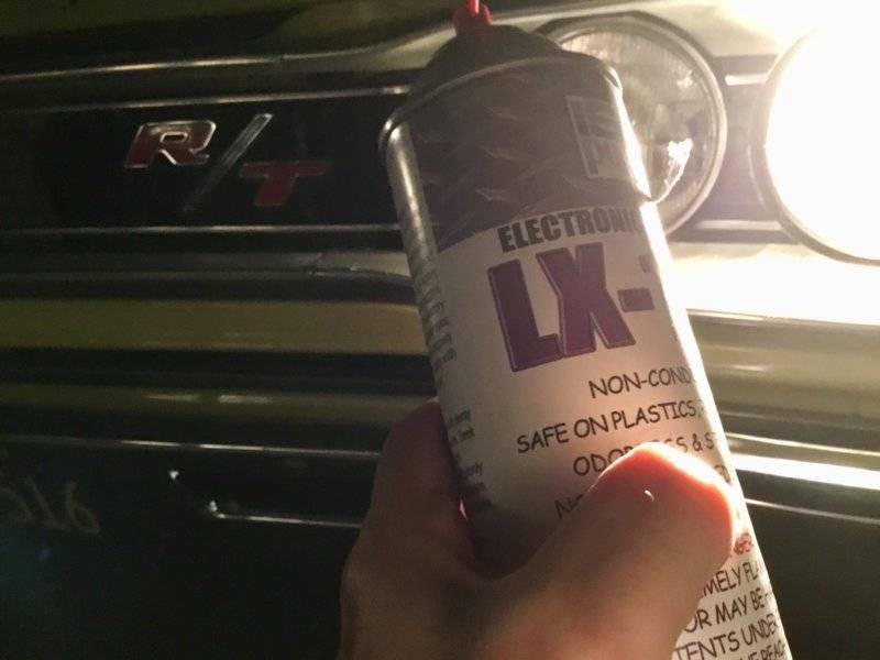

No low beam headlights
Shot some directly onto bulkhead connector, then into the dimmer switch. Got lights. Drive with one hand on the Halon.

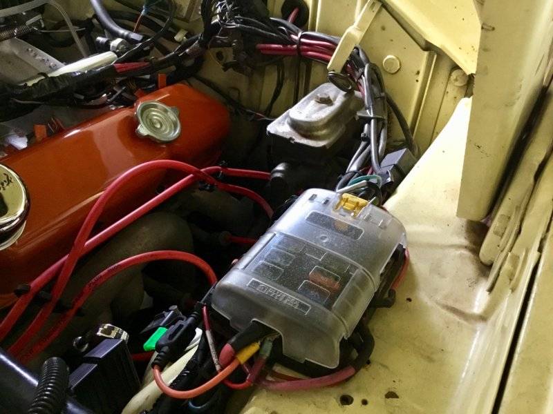

If he has high beams, that rules out the feed to the dimmer. Check output at dimmer and bulkhead connector. That would be the problem areas to look at as they are the only breaks in the wiring. Headlights ground through the same wires, high and low.
has wiring ever been replaced in car?
It would take a couple of minutes to look under dash at Bulk connector to see any wires pushed inside. That is how I found my problem. Or it's corrosion.
Yep. Same with the ignition switch, wiper switch, etc. Very easy to push each connection in with an awl or a pick.
No. M+H is on the shelf waiting. Now has what is left of the hacked up original. There is a box under the hood to support some add ons. It’s now running the computer to support the EFI too.
I and many others have done the ammeter bypass and installed an inexpensive headlight wiring harness with relays to address dim lighting issues.
Have you done that?
