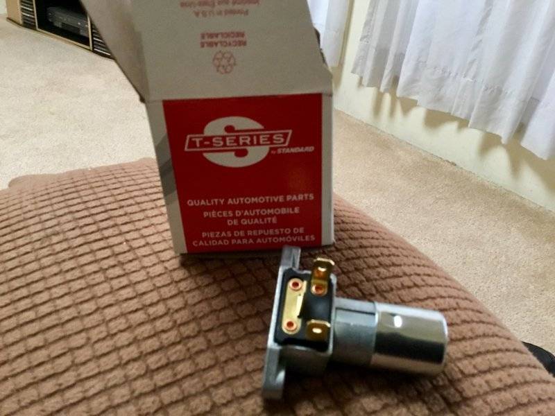

No lights again. Bought a $7 dimmer switch on Amazon. Will start there.
Overnight from Taiwan. Any advice.
The plug worked its way out over 50 years. Pushed the connector back in...headlights!
Yep, at the switch on the floor. I blame the boys on Lynch Road.
