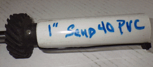

large screwdriver in the slot in gear, twist and turn and it will rise up....then grab it with pliers
look and see if end of oil pump shaft is still on the shaft
it looks like a hex wrench
