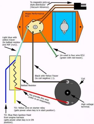

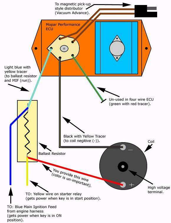

You could put a wire from the positive side of the coil to the power side of battery and then you should have spark. A new set of points, old style or electronic is not expensive.
K thanks. I used a light probe on all the ign parts the only one that didnt light up was the dizzy. The connector goin to the harness made a buzz sound and when connected, no light when probed on the dizzy side.
