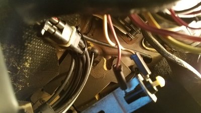

My buddy told me I had no brake lights I checked the obvious all the lights worked in the back. I figured it was the stop lamp switch so I replaced it still no brake lights. I checked power in the connectors with a test light and still nothing. I replaced all the fuses on the left hand side 1,2,3 and 4.
I traced the wires as far as I could go up to the hazard flasher they work no power to the ciggerette lighter also. I'm at a stand still can't think straight any more. If any one can help me I'd appreciate it.

View attachment 430211 View attachment 430212
The switch you see is the old one I haven't installed it on to the bracket I just have it plugged in

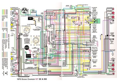

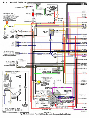

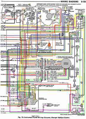

Looking at the schematic you may want to check your column harness connections, saw a 70 schematic that shows the break light switch is for the ground, not power...
underdash_rallye73a.gif underdash_rallye73b.gif Complete Wiring Diagram for 1970 Dodge Charger RT SE and 50.jpg
