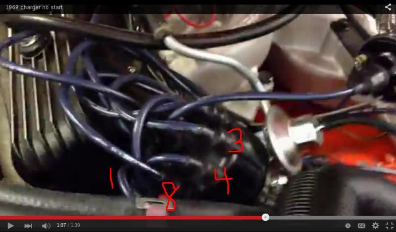

I grabbed this from the video . Mine is firing in this order. It starts with about as much starter as you have. It is probably a fuel problem if your getting hot spark and the compression is there. I have heard of cylinders getting washed down with gas and not having compression even after they dry. Not sure would have to be there to see it. Hope you get it soon.
