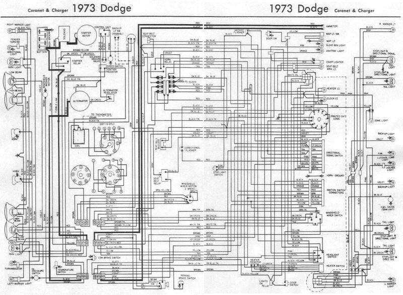

Thats fine for the rear if that was where his problem was. He has no front park or side marker lights so He needs to get a manual and follow the circuit.

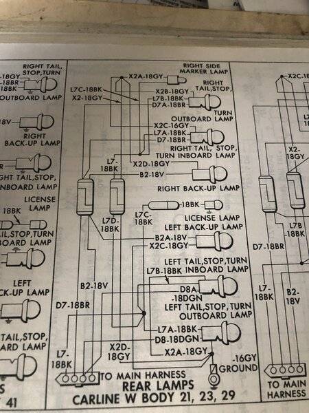

There’s a ground wire to the body in the trunk just before the harness enters the tail panel, also a connector above the license plate for the right side. Under the left kick panel up front is another connector that runs from the dash for light and fuel gauge as well. IIrc there’s also another chassis ground on the right side in the trunk where the harness runs to the rear side marker light. Good clean grounds are a must for things to work consistently.

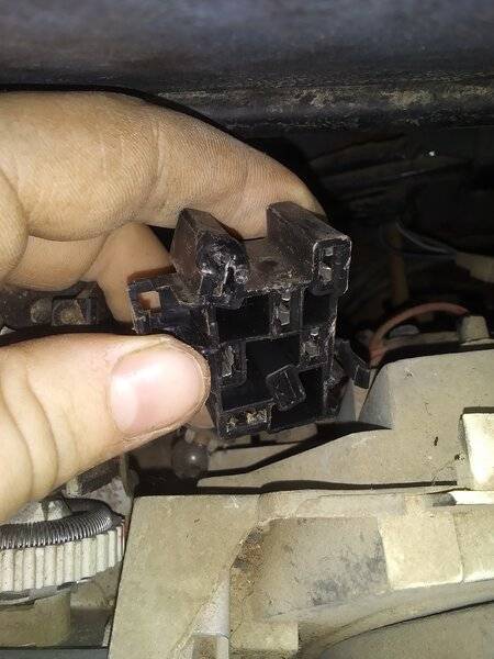

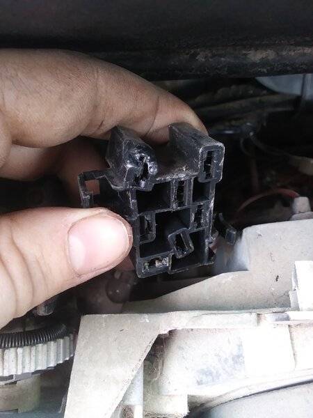

Ima clean the ground in the trunk first because thats where alot of dirt is at. I tried another turn signal switch out of another charger I have and it does the same thing. I took steering wheel off this morning to see if any wires were touching and it was fine. I think it maybe a short between the tail lights to kicker panel. Good thing most the carpet and back seat is out. Thank for the info guys
That looks like a good place to start and see what caused that connector to get hot. Do you have a good digital multimeter?
