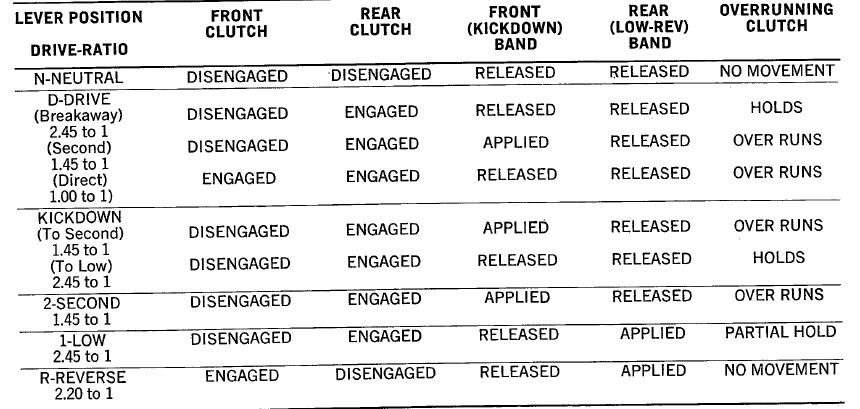

3rd gear drive requires both clutches to be engaged. No bands are applied in 3rd. The front clutch only engages in reverse and high - so if you have reverse it must be working. The rear clutch is engaged in any forward gear.
In the shift to 3rd the kickdown band must disengage while the front clutch applies - not sure what might happen if the kickdown band fails to disengage for some reason but I would think it would be apparent something was wrong - not sure.
If it will shift from 1rst to 2nd while in drive position it sounds like the governor is working. Kind of leaves the valve body or a servo as suspicious.

Download service manual, if you pull pan and valve body it tells you how to air test trans. It will narrow down problems. I sold a car and it was towed with front wheels off the ground. I bought the engine trans and rear back 10 years later. Put engine and trans in a car no high gear. Overrunning clutch?, never took apart to see what the problem was.
A couple other points/questions:
Is this a stock valve body transmission or does it have a manual valve body in it?
You may need to check the gear selection linkage and make sure it hasn't slipped and it's not moving the transmission lever far enough when the shifter is showing drive - for the transmission to actually be in drive.
