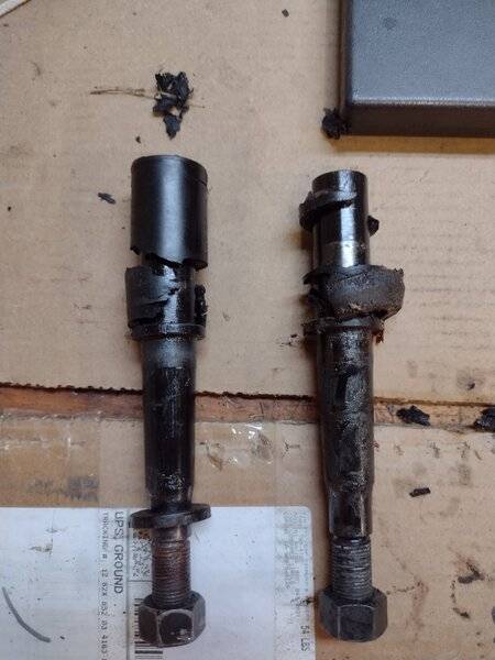

Any chance of some background to how they were installed before racing off and blaming the product? They were installed with my press in my shop with new shells and new shafts. And I don't drive it like the Duke Boys. The first time I slammed on the brakes when a Honda minivan pulled out in front of me the control arm slid back on the polygraphite bushing. And I also have new PST adjustable lower strut rods with the hiem ball fittings which I DO like. Here's your pic.
Pictures will speak 1,000 words.
Yikes, I wouldn't be happy either. Can't say that I've ever seen that happen before. Used poly in one car years ago and didn't like them. I only run rubber now.
I have the PST adjustable lower strut rods with the hiem ball. I had them adjusted properly. Nice to get just a little more +caster with my radial tires. Bushings were installed properly with new shells and new shafts on my press, not with a hammer. Just so you know I'm not some shade tree mechanic I have an automotive engineering degree from OSU and worked for GM for 17 years and have almost all of my ASE certifications. Like that means anything. Those tests were easy. I went on to get my Airframe and Powerplant rating and work engines and flight controls on Boeing 737s and do a lot of work on Cessna's on the side including engine overhauls. The strut rod out at the ball joint end of the control arm can't do much to keep the lower control arm bushing from sliding back in a hard braking situation. That's when mine failed.When you have a moment please private message me all of your information and I'll look into your issue. As for the lower control arm bushings if you're using the poly graphite style you would need to reuse your inner and outer shells. In Chrysler's design the lower control arm bushing is not designed to hold the lower control arm in place. The original rubber style bushings are vulcanized to the inner and outer shell and that in itself is not designed to bear the weight and hold the control arm in place from moving forward and aft. What essentially holds the control arm in place is the strut rod and strut rod bushing. If you have premature failure of the strut rod bushings this can lead to issues with the lower control arm bushings that you have described. Please feel free to contact me and we will work with you.

The early style bushings did not allow as much motion as the later larger 3 piece style. That is the reason they made the area that contained the bushing longer to allow thicker rubber. The thicker rubber allowed more movement , Replacing that rubber with a stiffer poly bushing just creates more friction and tears the bushing. The poly bushings do not and I say do not have a shear sleeve built in the bushings as pictured below as the new moog rubber does to prevent the destruction by the sharp edge of the K-member.
