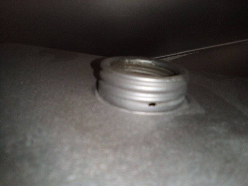

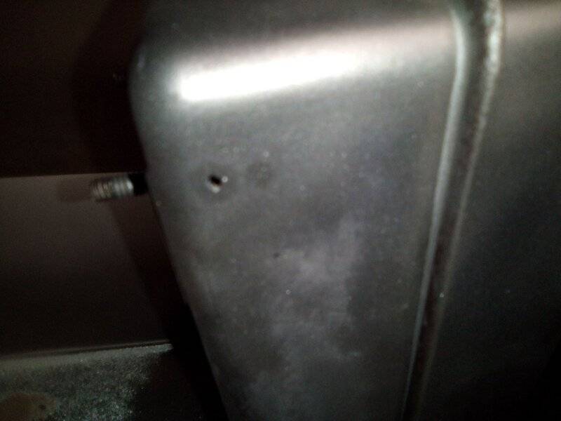

Here are some pictures of the tanks holes.....
Hmmm, the tank looks like you just painted it. Those holes suggest a bigger rust issue unless you are sure they are puncture wounds. Is there something hiding underneath those areas like very thin metal?
Anyway, I would use an old school rad shop to fix it. They can pressure test and make sure its good to go. If you cannot fork out $100, then you can try to solder it yourself. I do not recommend the putty options (temporary) and definitely not JB weld.
RGAZ
RGAZ
It was just sandblasted when I took these pictures, it is not painted yet until I fix it. The hole in the bottom picture to me looks like it went right through the tank
Ok, Gotcha. Then I agree soldering it. Back in my youth I was dumb enough to MIG weld my tanks (after filling them with water) but it always seemed to be a temporary repair compared to a solder repair which was much more durable.
