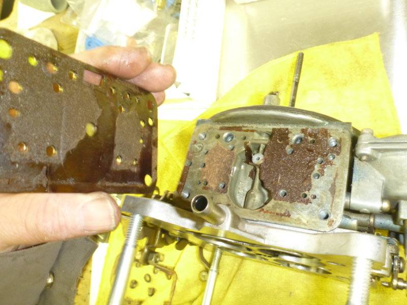

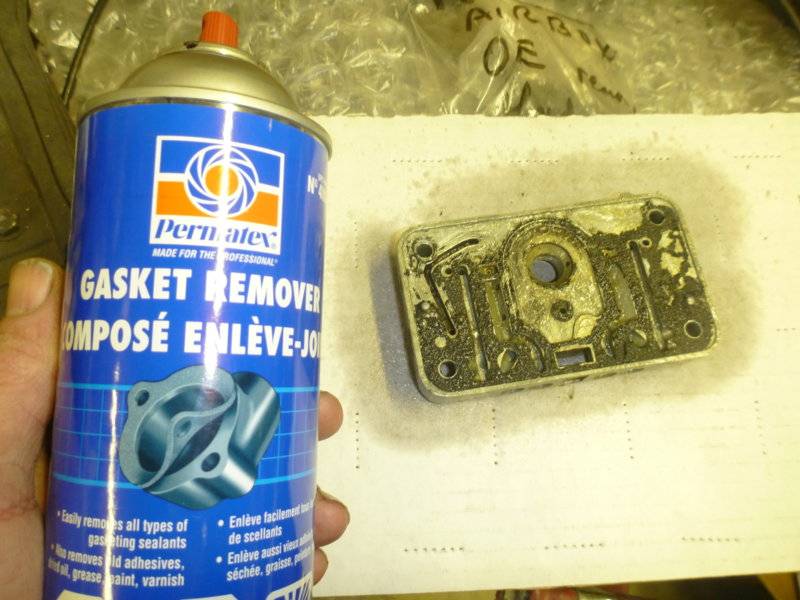

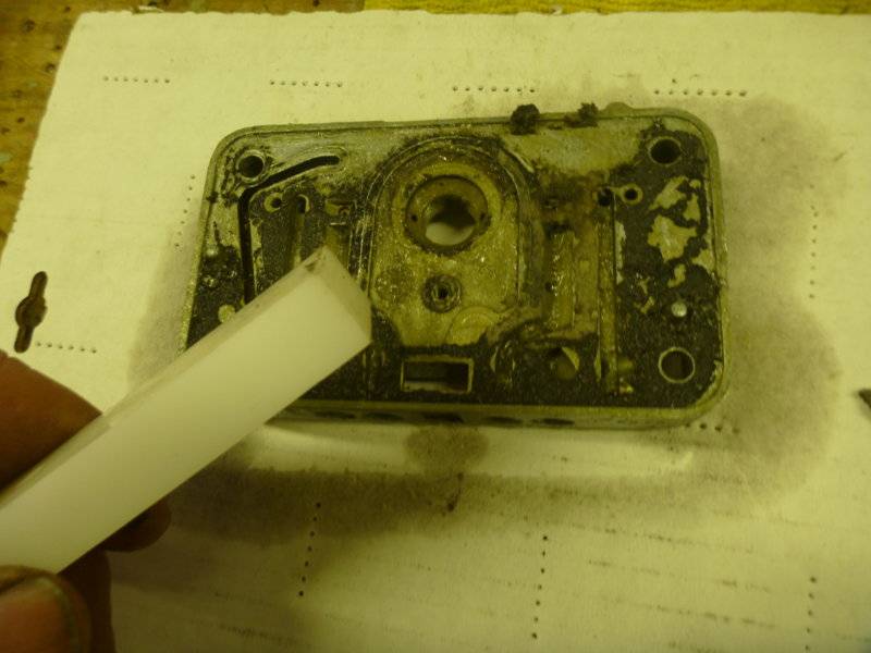

Sounds like my 750 I did last year. Wood block on top and a BFH ! Then the metering block I thought was bonded on as well. Then needed a spray can of gasket remover and a HD plastic scraper to get the gasket off...

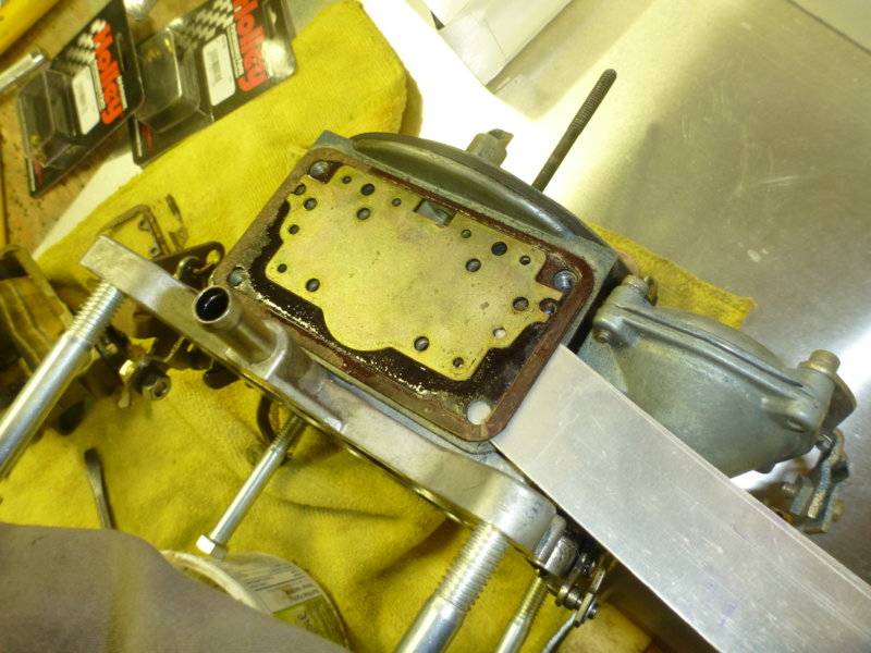

I've done quite a few, usually a screwdriver at the top catching first the edge of the float bowl and pry against the surface where the air cleaner sits... Second use the same location to pry on the metering block....
I agree with the gasket remover & the plastic scraper... Unfortunately it usually removes the dichromate plating... So try to limit how much you use & try to keep it off the most visible areas if possible...
