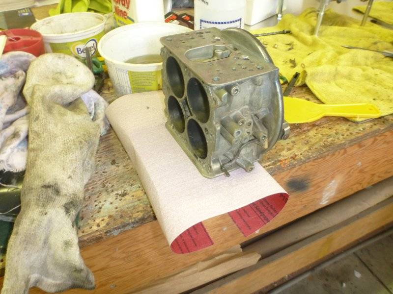

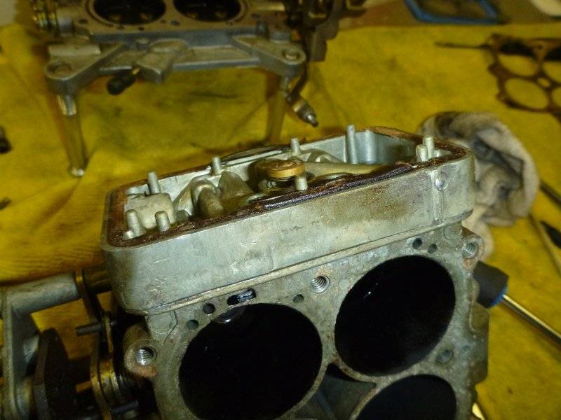

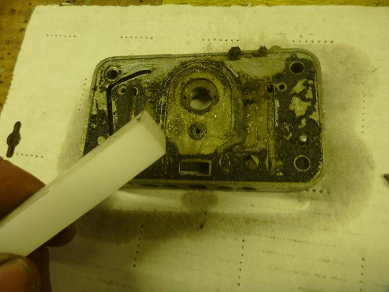

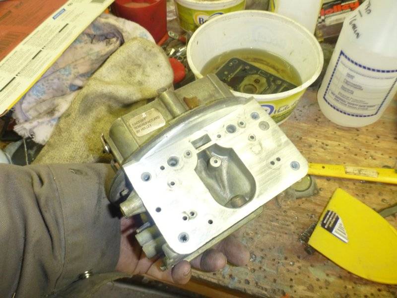

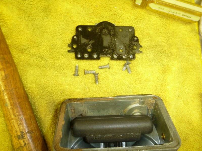

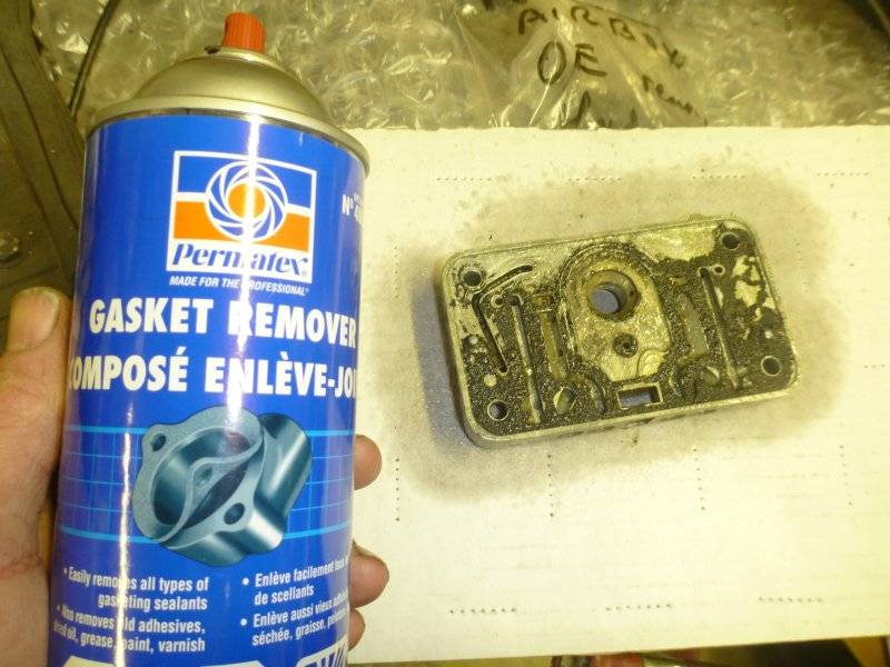

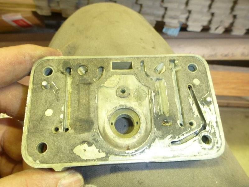

My 30+ year old Holley was no fun getting apart or cleaning... even with gasket remover. I damn near threw it in the trash...
A rubber mallet works pretty good for me with the blue gaskets but those old brown Holley gaskets are a real pain to separate and clean up.
