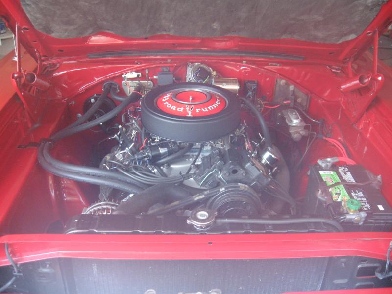

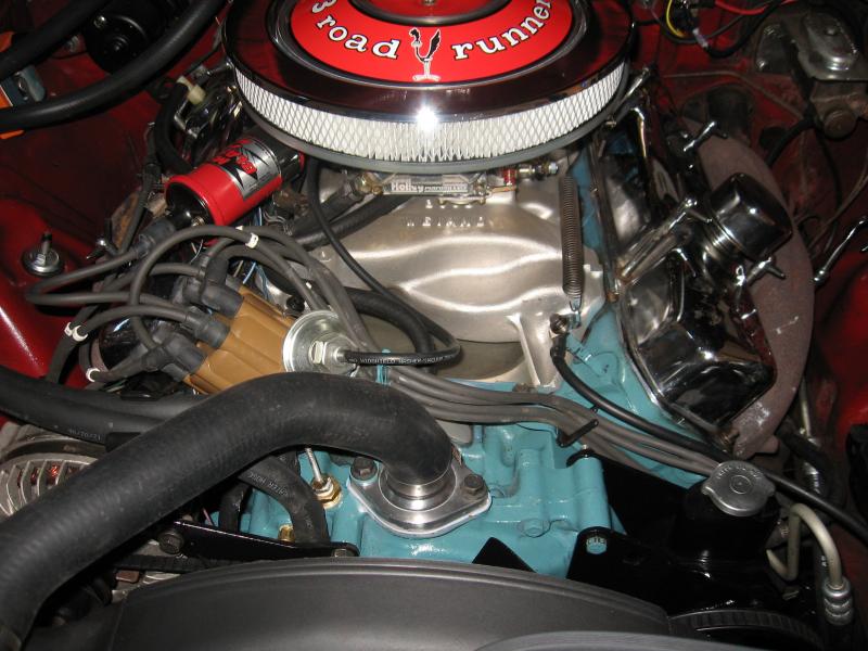

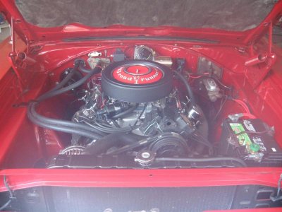

I changed the pulleys and brackets,My heater box was re built and the evap connections are capped off,the heater stuff stayed the same,might want to add it back at some time but not now. 69 road runner 001.jpgIMG_0493.jpg
