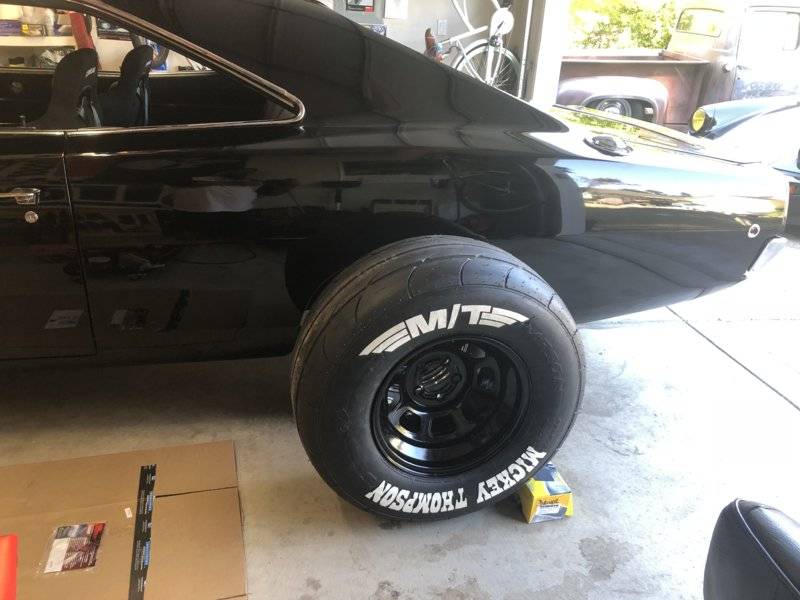

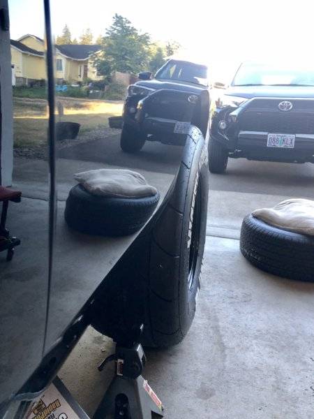

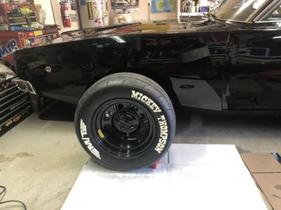

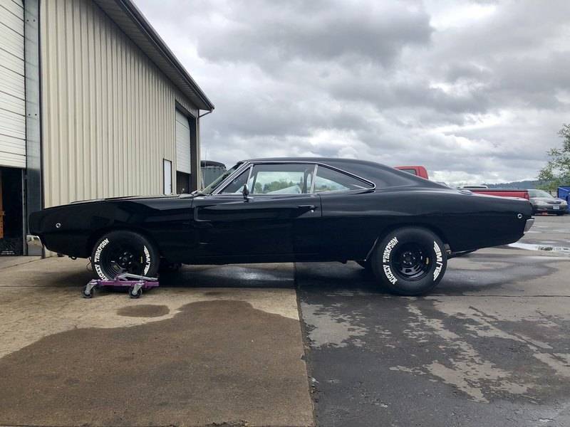

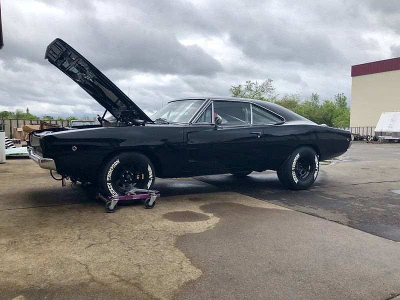

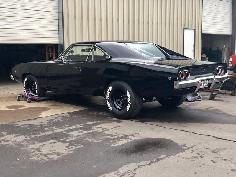

now to make Pandora mine!!!
I’m excited with how it’s coming along.
0D6CB6DB-8C0E-43E7-A911-FD2380C6427F.jpeg F978C90B-22EE-4D15-8AD9-ABC94D87A193.jpeg 1A8BC0C5-EFF9-46A4-AAA3-E3AD1CD5D1F1.jpeg B73048DC-8D08-4C66-BE04-D79DB9DFE4FE.jpeg

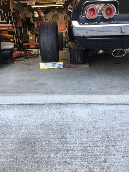

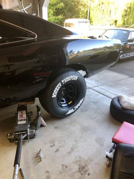

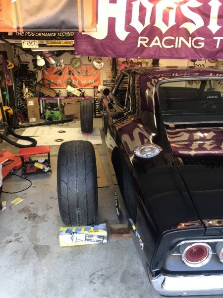

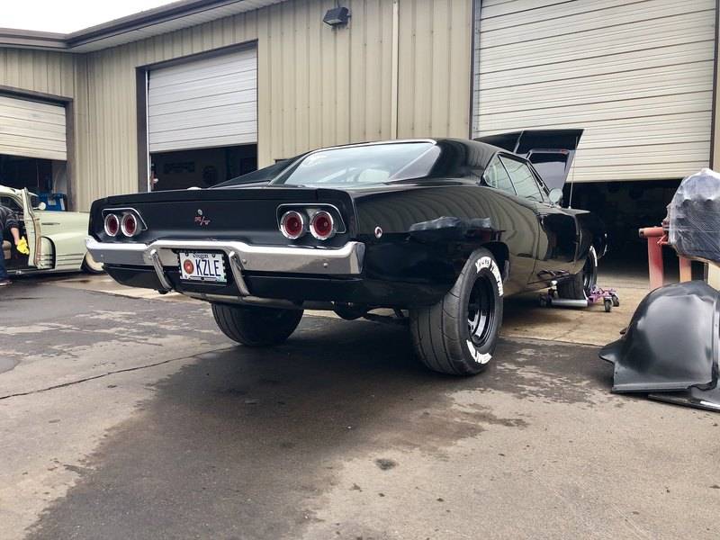

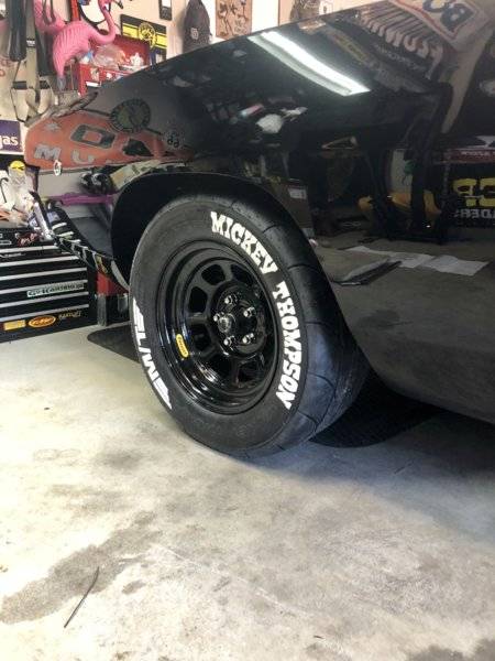

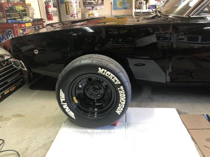

Fronts fit with no issues. Rears will require some massaging. Plan on relocating leaf springs inboard and going with possibly +2 leaf springs. Also contemplating a mini-tub.
B6A805D3-C597-4212-BAFB-9F761544EB0C.jpeg C6B1F6EE-455C-4C94-84B2-39056F86E819.jpeg 408B09DD-23A5-411E-A94C-CE591225EF38.jpeg
What size tire/wheel/backspace did you go with?
She goes in to MetalWorks shortly so I don’t have a definitive answer just yet as we will be moving springs inboard and mini-tubbing and removing that innerwheel-well hump. I told them that I can reorder wheels as just fitting them up seemed like I might have fitment issues. But I’m also contemplating shortening the rear axle and going with a wider tire but that too is up in the air.
