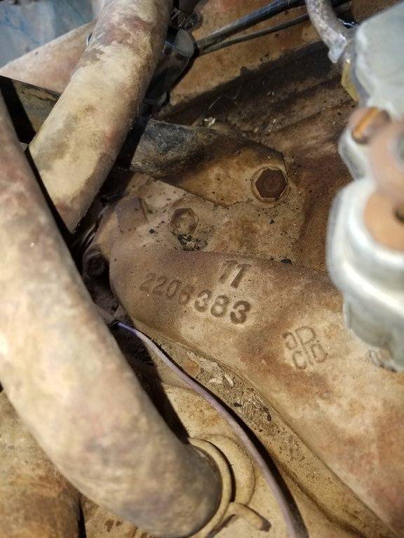

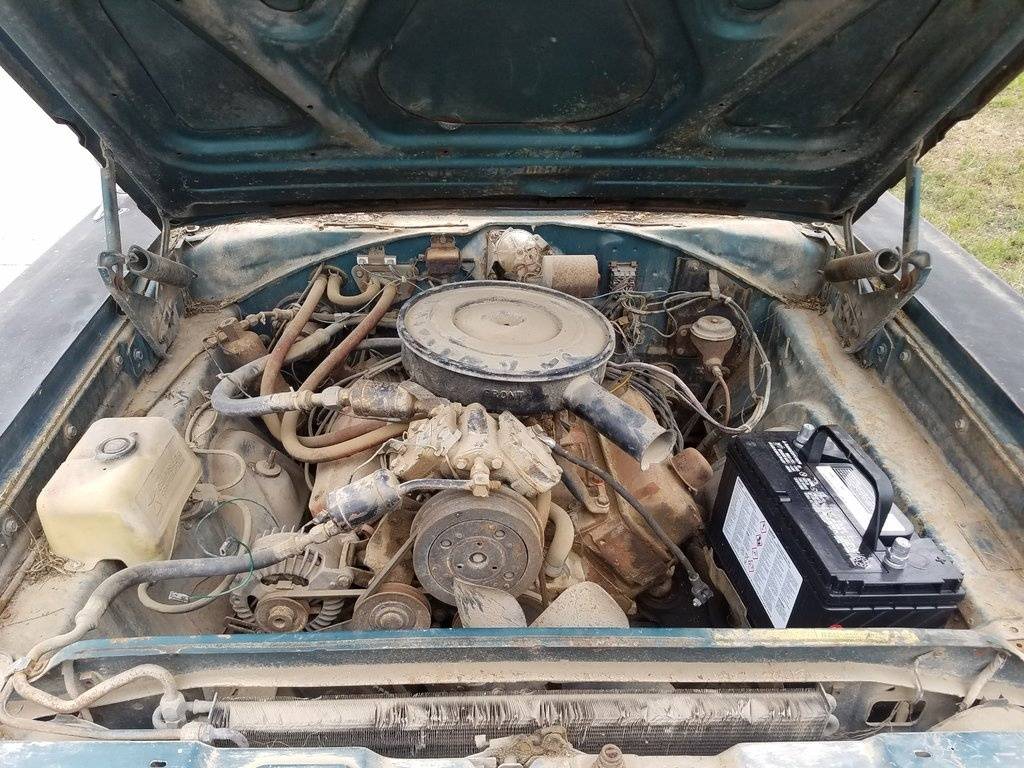

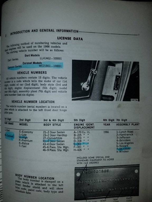

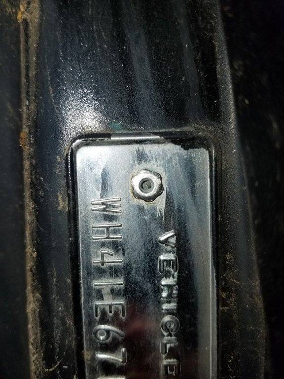

Here is a picture of the motor, partial vin number and a page from a service manual I downloaded.
I am not 100% familiar with 361 B big block same as the B line engines but I thought they had the distributors in front just like the other big blocks?
I could be wrong but it looks like a 318 wide block motor....
Is it a big block or small block? Where's the distributor? Basically, any A or LA engine whatever size will use the same pump.

Every part on the car has a PN/casting number that can be searched....
On the passenger side of the block is casting numbers also. Just below the exhaust manifold and above the oil pan.....
Ain't a 361, or any other RB or B block, distributor's near the firewall.
All big blocks are up front.....all small blocks are rear...
A 361 is a big block B engine
No, I just wasn't clear. I was saying that since his dizzy is near the firewall, it can't be a 361 or any other B/RB.
Poly 318.
IIRC the LA 318 fuel pump works.
VIN "F" would have been a 361 2 barrel, and VIN "G" would have been a 383 4 barrel.
Not sure about the 1966 Dodge FSM but the 66 Plymouth manual has an error in the VIN engine code section.
