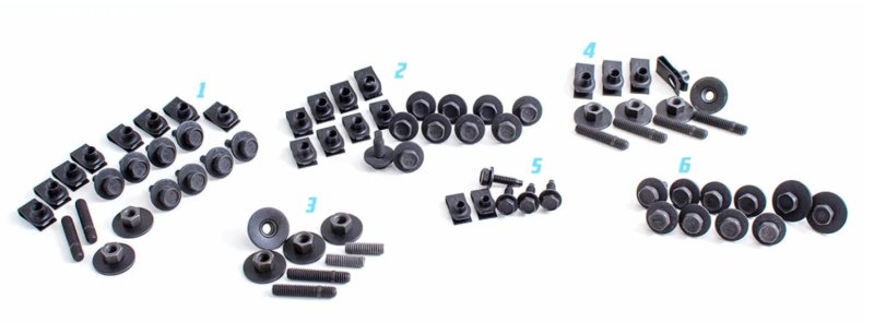

Hello all as i assemble my car which i didn't pull apart i've come up to bolting stuff up the panel beater/painter threw a few bolts in to line everything up but not in the correct places as all the bolts& nuts were pretty much thrown into one tub so it's fun and games at the moment.Anyway just wondering if anyone could help out by naming where these bolts go thanks ahead guys ps i know #6 is the hood hinges
#1 is inner fender n cowl studs,#2 is the same but you need studs for cowl,#3 is fender to cowl,#4 is bottom of fenders,#5 is front of fender where they bolt to rad support n #5 are door hinge bolts

Thanks Wayne, I did not know that! Is Chargersteven right on the rest of the locations?

YES Don, Steve was spot on.. I was just correcting the #5 #6 for hood/hinge and not door.
Now that said My Bee was that way off Lynch Road as was Justin's GTX. I just looked at my '66 HP2 that the hinges have never been off of and they are on normal size washers, so car lines and years may vary !

Thanks Wayne,was a toss up. Since he said he knew what # 6 was n said they were for hood hinges n no pic
Na, we're both screw ups as we should have been referring to #6 ! You had #5 twice.. I just followed the 5.. LOL

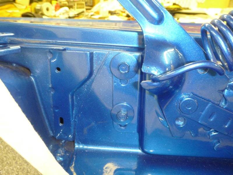

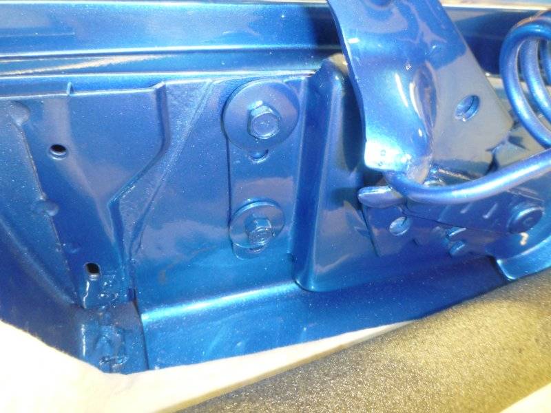

Just found pictures of my car which the original owner had sent me a while back that i forgot i had and just noticed mine had the front bolt on the hood hinges with the larger washer & the 2 rears were smaller washers.
Just found pictures of my car which the original owner had sent me a while back that i forgot i had and just noticed mine had the front bolt on the hood hinges with the larger washer & the 2 rears were smaller washewrong section my bad Bob H
