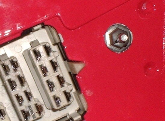

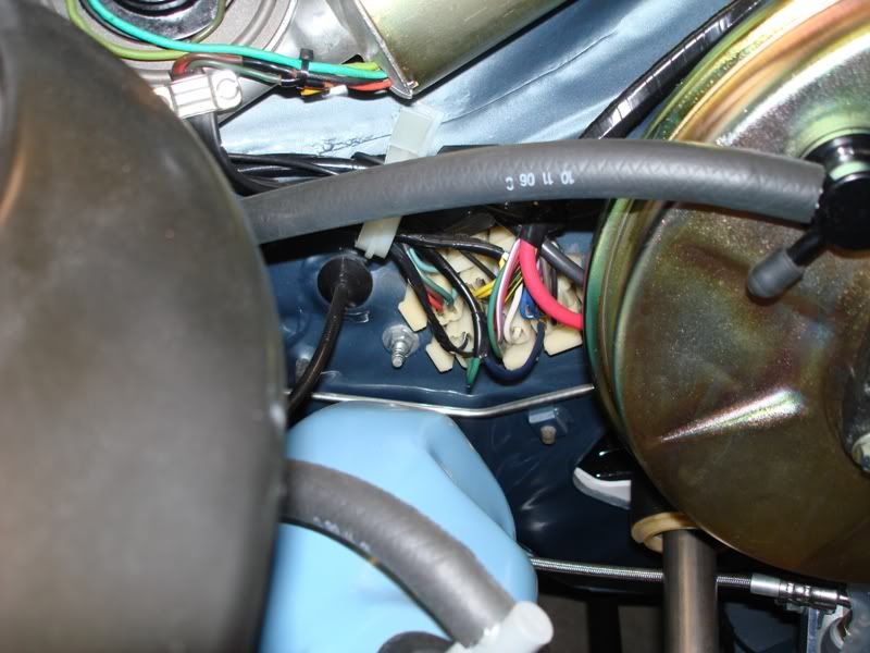

can someone send me a picture on the nuts that hold the electrical connector to the firewall on a 72 Roadrunner? I bought the engine compartment bolt kit but I've lost track of what's what and I have bolts and nuts everywhere

Spring clips hold the inside pieces together. There are 2 screws / bolts that go through the firewall with nuts on the outside

spring clips are on A bodies and up 70 B bodies. Since 71 B bodies were with screw and nut, like all E bodies.
Actually even is a nut ( 7/16" head ), I have found diff kind of nuts holding this... from a nut with a captive washer, up to a sheetmetal nut like the ones to the S spring clips for some molds, BUT STILL wit a captive washer built in
