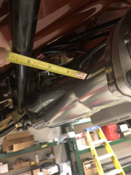

I’m looking to install a clamp on O2 sensor bung in my exhaust tomorrow and I want to make sure to put it in the correct location. I have seen people put them in the exhaust pipe 2’ away from the header and some in the header collector itself. Any recommendations?
Long ceramic 440 headers
should be in the collector if possible
thanks for the pics
Mine’s in the pipe directly behind the header collector....only cuz i didn’t want to mess up my ceramic coated TTI’s. The EFI works fine, too.
Yeah, I ended up doing the same thing because of that as well and I was able to get better angle with the clamp on style bung also.
