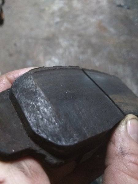

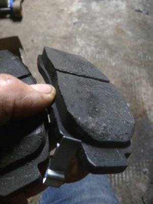

2002 Acura TL type S brakes new all around. On the first test drive, real bad grinding from driver front. Got worse turning left
Found the outer edge about 2 inches in on the outerside of the rotor, had heavy wear, just 3 miles
Replaced pads, thinking poss defective pad, see problem
Replaced rotor, caliper , and pads. Not as bad, but still noisey and most wear on the outside pad and rotor surface.
Bearing was recently replaced by some one else, with new hub. I made sure rotor sits square as I tightened the wheel. No wear on the bracket from rubbing on rotor, and bracket was replaced.
These photos are 3 miles, new rotor, pads, caliper and bracket
What am I missing??? I'm stumped

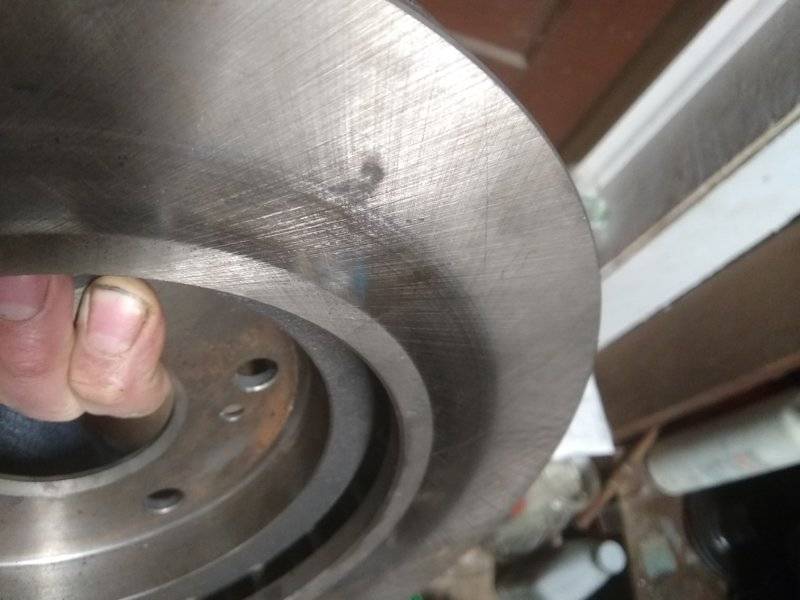

Inside of the rotor shows a little identical wear, but not as bad as the outside

Here is the inside of the first new rotor. Wear is in a different spot, and just glazed, not dug in like the outside
Did the caliper come with a new bracket? Some do, some don't.
Does the driver side rotor have a normal wear patteren across it and not halfway like the passenger side?

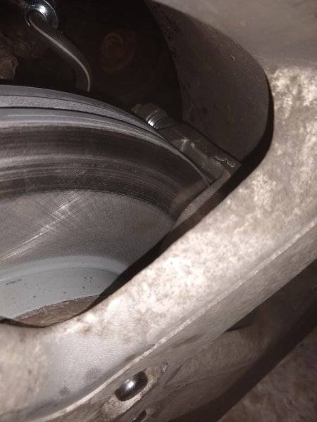

Just saw this picture.
The wear patteren is at the top outside and bottom inside. That's showing either the bracket is bent or where the bracket bolts to the spindle/strut is bent or misaligned for some reason.
Or spindle is bent.
Or spindle is bent.
That or bearing run-out is were I'm leaning too. Maybe bent during bearing install
You think that would be obvious ( link, rust peeling)
But I see nothing. I guess I'm gonna have to measure and compare to driver's side?
Bingo run out shown by pattern on rotor. Check hub runout also see if rotor fits flush.

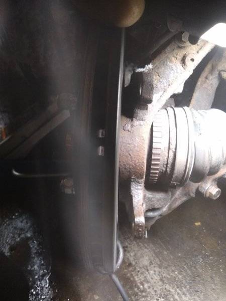

Hard to tell from photo, but it looks like the ears are bent away from the rotor. I installed a thin washer between the bracket and spindle, and it's good
Looks like it probably got bent during bearing work. In MN, some of them come out HARD!
Thanks for the help!
