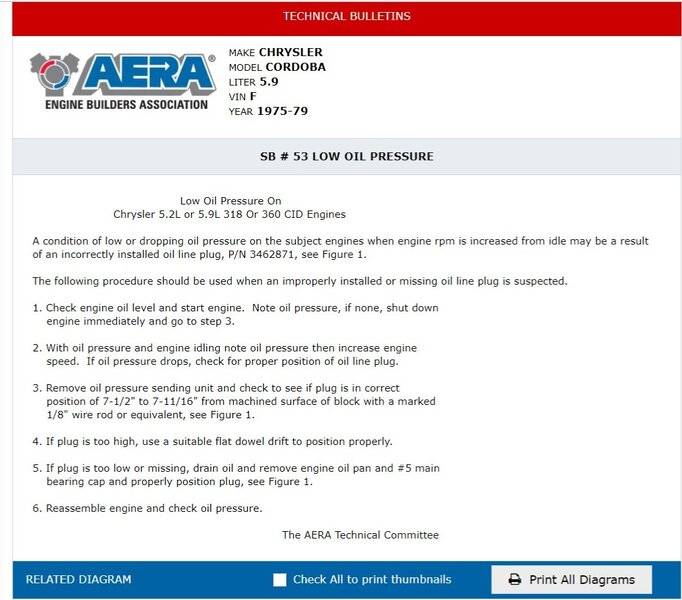

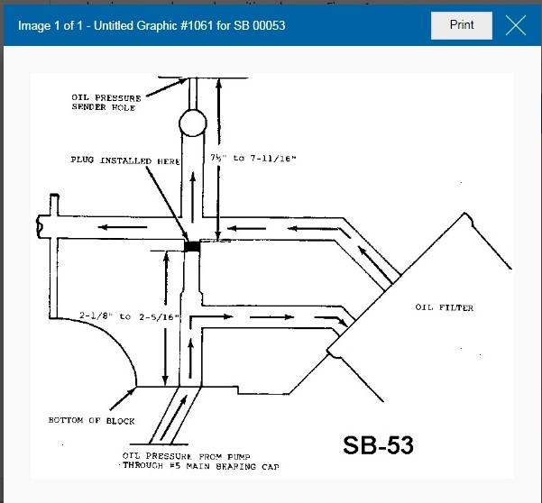

One issue that can cause low oil pressure, especially after an engine rebuild is forgetting to install the small (~1/2"-9/16") freeze plug under the rear main cap. This plug diverts oil thru the oil filter instead of bypassing it. You can remove the oil sender and measure from the block, down to the plug. You should measure about 7.5" to 7.6875" (7 11/16") to the plug from the top. If you don't feel the plug, it is missing and needs to be installed from the oil pan/main cap side.
View attachment 1187731 View attachment 1187736

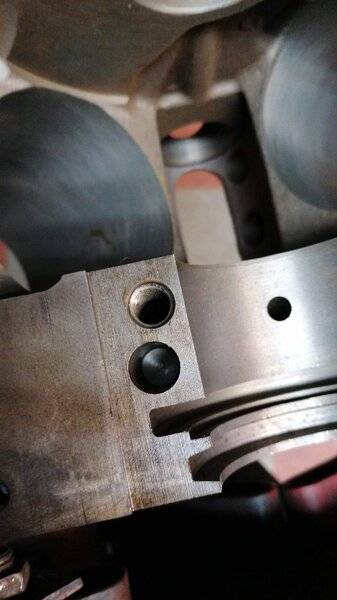

Thanks. Is this the plug you are referring to?
Yes it is, but even though it is there, it kind of looks too close to the main cap parting line. It should be ~2.125" to 2.3125" (2 1/8" to 2 5/16") from the main cap parting line. Might just be an optical illusion though.
Thanks. This photo is not of my engine. It was supplied by a POLY friend. I'll check the distance from the sender hole down as per your instructions.

Just pulled the sender and measured down. The plug is there and measures 7 9/16” to the block plane. Onward, I guess but thanks so much for helping
