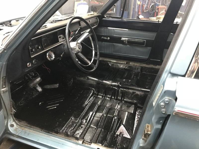

I cleaned up some rust and primer and tremclad painted the floor
I am putting the carpet back in and wondering what was there and what people do

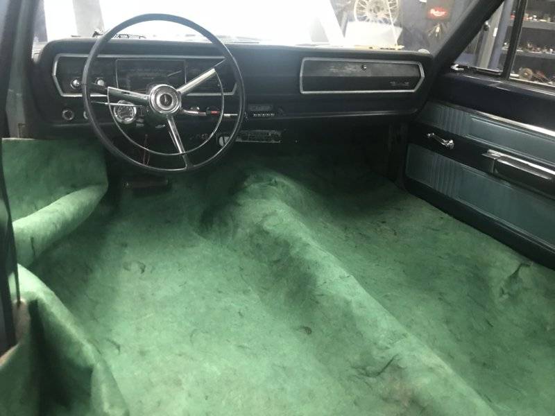

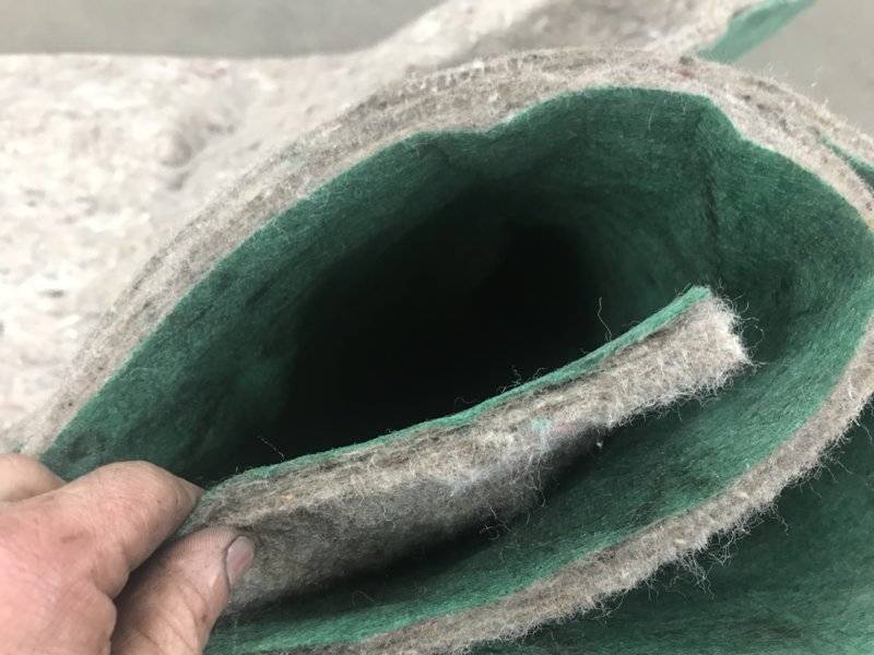

there s a jute very thin I think I'm going to add and some dynamat strips

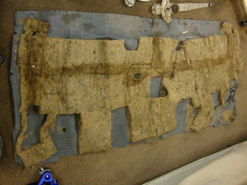

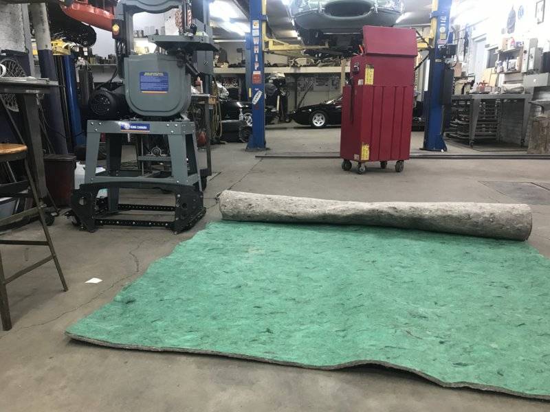

The original insulation was a brownish thick horse hair type....no one reproduces that.....
This is actually an original 67 B body floor mat.....The jute was reused on my current build...
