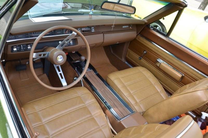

Is anyone familiar with this color interior? This is what I have in my 1969, and I assume the seats are the known “saddle” color. What color is the glovebox considered, brown? It wouldn’t be called “saddle”, too, right? It’s clearly not the same as the seats.

Colored interiors originally never matched....It was a collage of similar colors from multiple vendors making the parts....So when you see a car someone cars as 100% original with a blue interior of one color its not correct.

The trouble with SEM is they don’t specify that their saddle-type color is the “650” Mopar saddle the seats are. Like one of the posters said and evident in my photo, there are many shades of saddle used on various parts, so I’m are having a tough time determining what would match my new legendary seat covers (when I order them) when I paint the headrests. The OER brand actually says “650” and looks close in photos. The Herb’s saddle looks dark on their website.

so what color did you finally go with? (part number) I have the same issue I bought sem Saddle and its not right at all. thanks

well I bought a can of saddle from Herbs on jan. 7...……..still waiting on it its stuck in the mail somewhere

ok finally got my "saddle" paint from herbs. don't waste your money. only color it matches are the arm rest, the search continues for the brown I need for my kick panels and dash...….
