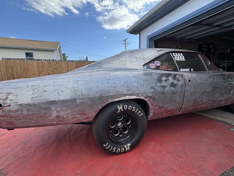

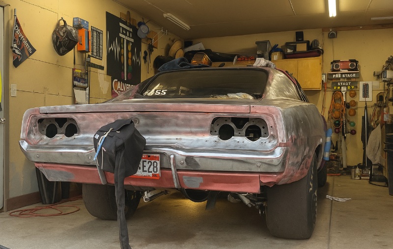

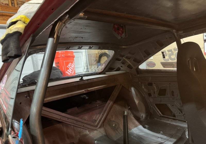

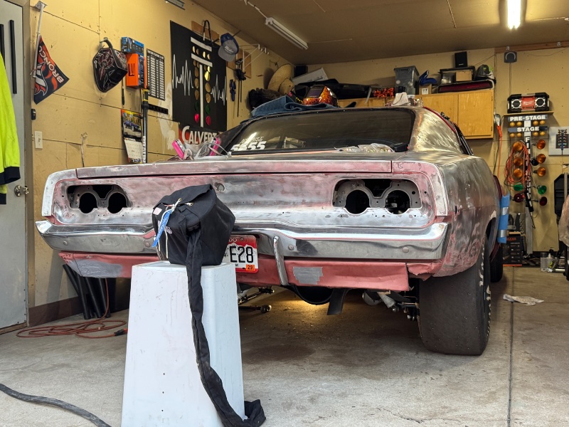

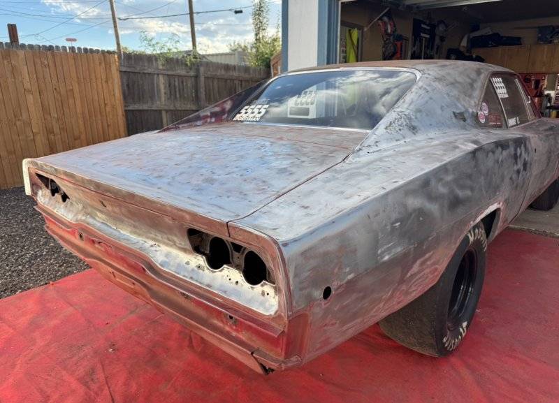

Body work and paint is the first project. Body work is extensive as it has hail damage from sitting outside for 30 years. The original red has been primer’ed over.
Plan is to use Summit Racings epoxy primer after getting it to bare metal in most places. Then fill before sealing and going with a single stage with a clear over it. My plan is to paint with a $1000 budget. Currently I’m at $600 with everything except for paint. For guns, I plan to use TCP global’s kit including a 1.4mm and 1.7mm. It also comes with a handy 1.0mm for the jambs which I do plan to paint.
I will also paint the inside of the doors, hood, trunk and possibly the engine bay as well, but not the interior. Which is getting a total rework in its own way.

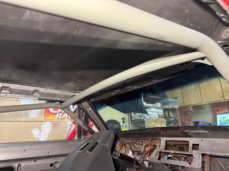

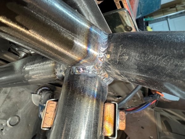

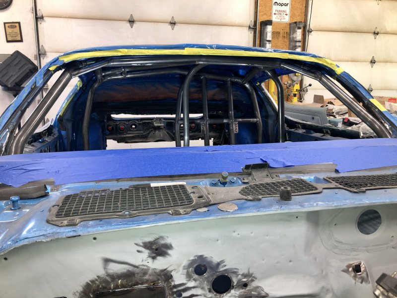

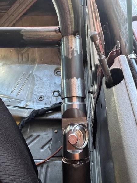

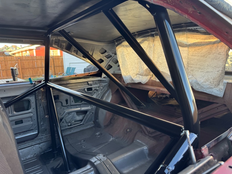

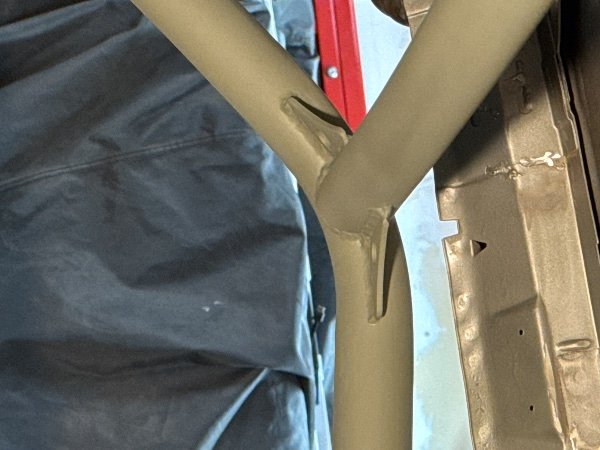

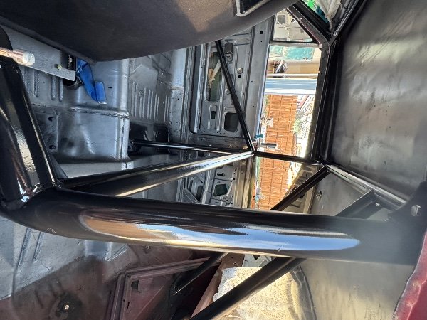

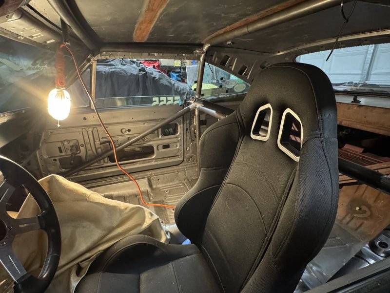

Metal work begins shortly with not only several patches but a 10-pt roll cage!
