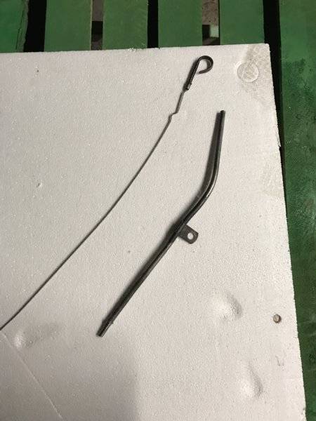

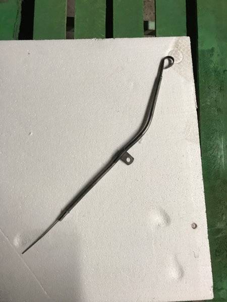

Here are pics of the dip stick I have for the car but not sure it's right or not. I also included a pic of the hole for

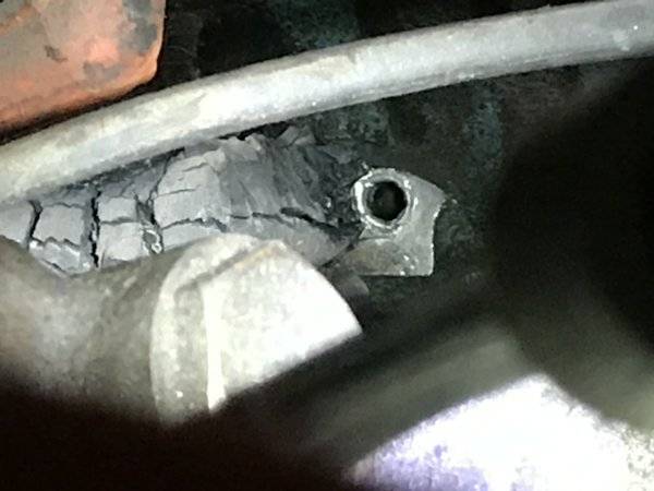

The dipstick, I know it's not a great shot, but can anyone tell if a previous stick broke off in there? Thanks in advance!

Sure looks like there is one broke off in there. Should be a nice clean round hole.
Might be able to grab it with a spiral easy out. Be careful though...
Would I be better off dropping the pan and trying to tap it out you think?
